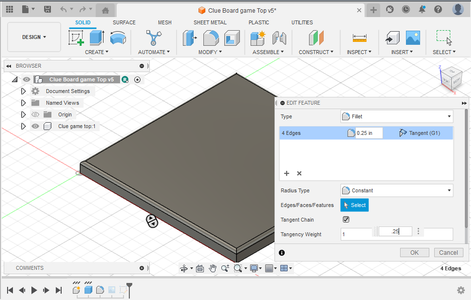

After creating the box, fillet the edges as desired such as a 1/4" edge.

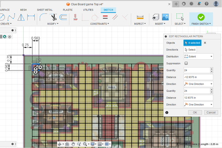

Next, create a sketch on top of the box. It is important to create the sketch second, otherwise, you won't be able to see the image while you edit the sketch.
I started the design by creating a rectangular pattern for the dice squares. I placed the first rectangle .75" from each edge. Then I used math to find the exact dimensions to use. First, I subtracted 1.5" (.75" from each edge) from 15" to find the box size for the rectangular pattern. Next, I divided that by twenty four (the number of boxes) which gave me 0.5625" as the size of the boxes. Now for the actual pattern, I selected the geometry and set the distance as 12.9375'' (13.5-.5625) in both directions and put the quantity to 24.
The next step is to delete the rectangular pattern constraint (see above for an image of the rectangular pattern constraint). Once the rectangular pattern constraint is deleted, you can delete the extra lines and create the rooms. I kept the rooms very simple and traced only the outlines of the rooms and centered the name of each room in the outline of the room.

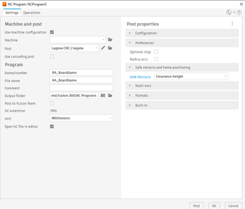

Posting the process is super easy, all you have to do is click the operation you would like to post and click the post process button. On the top left of the pop-up, you'll choose the machine you have. I chose a Laguna CNC because that is what I use at school. The next setting to change is the safe retracts, if the drop down says G53, change it to Clearance Height. After that, post the process to a USB drive.
After posting, you should quickly read through the NC code to check for anything that seems off. You should especially check the Z height. Your Z height should be the negative stock to leave that you chose. Another thing to check for is the Z-0 at the bottom of the first few sets of lines. If you see this code, delete the Z-0, and save the file again. Once you've checked that everything is okay, simulate to see where the tool starts cutting first, eject the flash drive, and walk on over to the CNC machine.

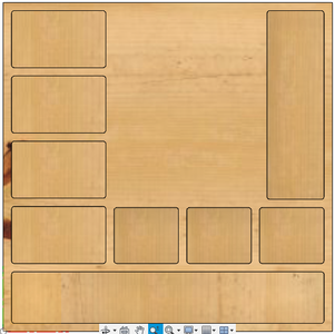

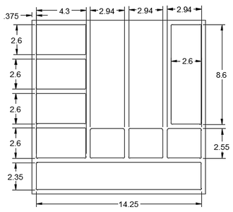

As you probably guessed, the first step is to create another box in Fusion. The length and width should be exactly the same size as the top, however the depth should be at least .75" in order to hold the game pieces. If you can find a thicker piece of wood, use a thicker piece of wood.
In order to create the pockets, I measured the game pieces and created the pockets using the measurements. The dimensions of the nine pockets are shown above, all the edges are filleted to .125", and the thickness of every wall is .375 inches. I extruded the four boxes for the cards and the envelope by a quarter inch. I extruded the other pockets by 0.6 inches. However, if possible make it deeper because then the pieces will fit better.

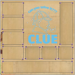

Notice the giant block of space on the bottom of the box? Well that's because it's a perfect spot for you to customize.
You can do whatever you want in this section. Add a picture of your mom, an image you found on Google of a clover, a falling leaf, you're favorite quote, whatever floats your boat. I decided to laser-cut an image of Sherlock Holmes with the caption of "can you solve it???" and Clue.

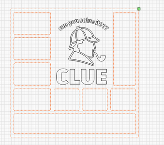

I started by inserting the image of Sherlock Holmes into Fusion and tracing the image in Fusion. Then, I projected the outside of the box and area that will be cut, so I could see it when I inserted the sketch in Fusion.
Next, I added the text.The CLUE was just the regular text box, but the "can you solve it???" followed an arc instead.
Next, I exported the sketch as a DXF, and imported it into LightBurn. In order to import the sketch you have to right click on the sketch you want to export and click save as DXF. Look at the above picture for reference.
Now on to LightBurn.

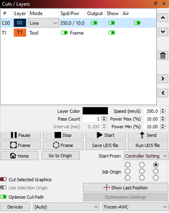

The first step is to open LightBurn and set up your machine. If you have used LightBurn before, you can skip this step. In order to set up your machine click the device button, find your machine, and update the details to match your machine.
Next, import the sketch and change the lines that won't be cut to a Tool, the mode to fill, and the speed and power to 350 and 10 respectively. Now that the settings and design are ready focus the laser cutter, send the file to the machine and press start.

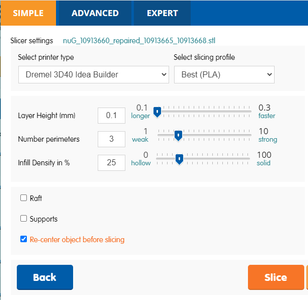

After adding the felt as an afterthought, I realized the dimensions I had for the existing pieces no longer fit, so I designed all the parts in Fusion using a mixture of loft, pipes, and a lot of time. Since printing the parts takes about two hours and the design is pretty standard, it's easier for me to just give them to you, so you can save yourself a lot of time. If the design is somewhat lacking in your eyes, mess around with it, and make it perfect for you.
The next step in 3D printing is to save the file as an STL and import it into your 3D printing software. I use Dremel, so I imported my sketches into there. Next, repair the pieces, insert all the individual files into one big file, and send it to the printer.
If you use a different 3D printer, or you know a better way, feel free to change the settings, but the above pictures are the settings I used when printing.
