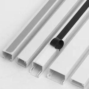

For the electronic part, I used color changing blinking/flashing LED Diode and a soldering iron with a heat shrink tube and a PVC channel for cables 10 mm.

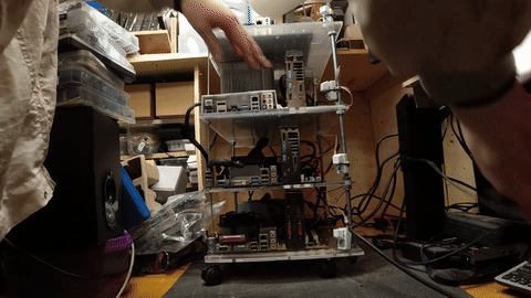

In second design the only way ... if I think of using only 4 threaded rods, is to use some base, tray for the motherboard, and that's where I get the idea to use the plastic I save from disassembled LCD monitors.
4 plastics are from a 22" LCD monitor and one from a 19" that I used to thicken the bottom for strength.
The older the monitor, the thicker the plastic.
First, I marked out one plastic plate as accurately as possible and then I used it as a template for the others.
Now i learned my lesion and before assembling the structure, I did test the components clearance and the graphics card does not sit well because it rests on the plastic.
But I solved that easily by first marking where the graphic support touches the plastic, then I drilled a few pilot holes and finished cleaning the so-called channel with a dremel tool. I did same for PCI card also. Now it fits perfectly.
There will be 4 threaded rods, 3 of which are thicker 8 mm and one is 4 mm, because I want all motherboards to be connected to the same ground, and the thinnest one will pass through all 4 boards in corner.
With a little Wiggle, all the panels fit into place without any problems.
On each side, before I put the nut for strength, a washer was put everywhere.
There are small problems such as: it's too heavy to move, it's too high and it's too wobbly for now.
So I put wheels for easier movement (front wheels have a brake), I shortened the rod a little because it's always better to leave it a little longer and then shorten it later, and after a slight tightening so that the plastic doesn't break, everything is pretty strong.

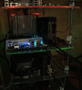

For the LED indication that the computer is on, I used the fact that I have transparent plastic on which the motherboard is placed, so I will drill holes through the small 10mm cable channel and connect LEDs in parallel.These diodes have a chip in them that randomly changes colors. For the test, I put it on the front to check if it could be placed and connected like that and I really like it, it's quite subtle but also quite bright so you can see which computer is on.
 It's hard for me to capture what it looks like on camera, it's much brighter in person.

Multiple computers work at once without any problems. I still have to connect old components like PCI cards that i want use and install a few operating systems so I have a lot to choose from ( i can easily connect different HDD on each level).
I know that I could install a virtual machine and put any OS, but I see the advantages when it is done in this way, especially if I already have all the components.
 As you noticed, the rear end of the motherboard is facing forward, this is because I often put and remove cables, dongles, etc, so it fits me much better this way.
It's easy for me to pull, turn and it will come in handy when connecting other components or when cleaning. The total weight of everything is approximately 24kg (~52lb).
