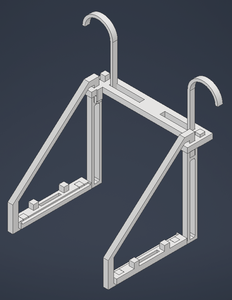

The shower in our dorm lacks shelving units for storing supplies while showering, which often results in bottles of shampoo and body wash piling up on the floor, creating an overall messy and disorganized space. I have endeavored to fix that by making a shower shelf made of 3d printed parts that slot together and hangs from the knobs on the shower without requiring any fasteners. This shelf design can be easily modified to fit any space by changing only a few dimensions.

1.2 Sketch Part Prototypes:
  1. Sketch out your shelf area and knobs on paper, then start to sketch the parts that will connect them, making sure to dimension out each part.
  2. Determine a method for assembling the parts. In my case, I went with a square slot and pin method to reduce movement.
  3. *Keep in mind the dimensions of your print bed when designing parts*
  4. Use modular designs when possible to minimize the number of parts you have to design.
  5. Keep shapes simple and 2-dimensional when possible for ease of design in CAD.
1.3 Design Parts in CAD Software:
  1. You can design the parts using any CAD software, such as Autodesk Inventor, Onshape, or Tinkercad. For this project, I used Inventor as I am most familiar with it.
  2. *Check tolerances on 3D printer* This can make or break your design and waste material, having to reprint parts. The printer I am using has a tolerance of +/-0.002mm, which means that any given print could be that much bigger or smaller than the intended dimension. Keep this in mind when designing your parts that fit together, and try to either make your slots slightly larger than your pins or vice versa by the tolerance margin.
  3. Start modeling out your parts. You should just be copying the designs and dimensions you had on your paper sketches, then extrude those sketches out.

  3. Use a metal file or sandpaper to file away rough edges and smooth out pins. If a pin will not fit in its slot, it is usually better to just file it down than to reprint the entire part.
5.2 Assemble
  1. Slot all your parts together, then set your shelf into the holder. I would recommend using some sort of hot glue or epoxy in the slots to keep all the parts together and prevent them from shifting around, and I would also recommend gluing the shelf into its slot to prevent it from slipping off when you place your supplies on it.
