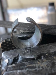

Cut a piece of metal tubing to 7/8 inch in length. The tubing should be about the same diameter. Electrical conduit works well. You may even make your own tubing by forming flat stock around a piece of pipe.

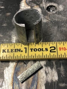

Step 2: The Opening
Cut out a piece to leave a gap of 1/4 inch. The gap should not be less than 1/4 inch. See the second photo. Grind or file a chisel edge on one side of the opening.

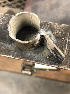

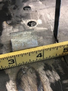

Step 3: Preparing to Weld

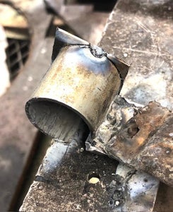

Cut a piece of flat sheet metal 7/8 x 1 inch for the bottom of the mouthpiece. The photo shows the body of the whistle with the chisel edge away from the mouthpiece. The body of the whistle is against a piece of scrap wood. Also against the scrap wood is a 1/8 inch spacer. Against the spacer is the piece for the bottom of the mouthpiece. A line extended from the top surface of the mouthpiece should pass 1/16 inch under the chisel edge on the opening.
Step 4: The Weld
Tack weld the bottom of the mouthpiece to the body of the whistle. Ideally, the weld is in the acute angle where the mouthpiece meets the body. In reality, some of the bead is mounded up on top of where the two pieces join. It can be ground later to provide a flat surface for welding the sides to the body. (I have my welder set up for flux core wire rather than gas shielding.) Once the bottom of the mouthpiece was tacked to the body of the whistle, I welded the other side of the whistle. Because the tack weld kept everything secure and immovable, I was able to weld in the acute angle between the mouthpiece and the body. A couple of tack welds are all that is needed.

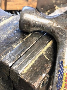

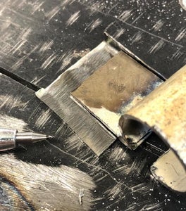

Step 5: The Top of the Mouthpiece

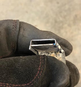

I put the piece for the top of the mouthpiece into a vise and allowed about 3/32 inch to extend above the vise jaws. Then I used a hammer to pound that over to form an “L”. See the second photo. I used a scribe to mark the width of the mouthpiece. My vise jaws were not too high from top to bottom and I could put the piece back into the vise to fold the second edge over. See the third photo. I tack welded on the right side of the mouthpiece as seen in the photo. Note the overhang on the left side. I cut that away before welding. Then tack weld the left side, too. Note: The steel becomes too hot to touch during welding and grinding. I waited several times for it to cool. I also wore welding gloves.

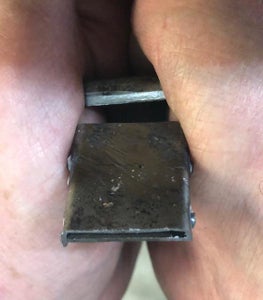

Step 6: Testing
Grind or file away rough edges that can cut or scratch your lips. Notice the path of air through the mouthpiece comes just barely under the chisel edge on the whistle opening. See the second photo. Lightly press the base of your thumbs against both sides of the whistle’s body and blow through the mouthpiece. If you do not hear a sharp loud whistle sound, check to see that the opening is 1/4 inch wide. You can also bend the angle of the mouthpiece just a little so the parts align as in the first photo. In the second photo the right side of the chisel edge is a little higher than the left side. The whistle worked fine, but I made a minor adjustment for the sake of appearance.
