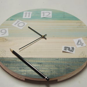

See the images for the front and back of the clock for how it should look after cutting out.

8. For the numerals, I printed these out on my PC printer and then transferred this onto the clock face. Mark the location and double-check the placement.
9. The numerals were then outlined and filled using a black Sharpie pen.
