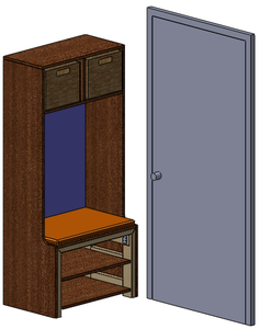

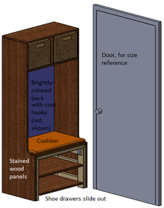

Introduction: Coat-rack With Sliding Shoe Drawers
I include full CAD files and photos. We made it at Techshop (www.techshop.ws). Actually, we cut and drilled wood at Techshop then took it home to paint/stain and assemble it -- because we only have a small car so couldn't transport it home if it were assembled.
Step one is to take a look at finished product photos and screenshots, and download the CAD file from: http://davidnhutch.com/fileshare/CASR.sldasm (Solidworks 12), http://davidnhutch.com/fileshare/CASR.zip (STL files and assembly)

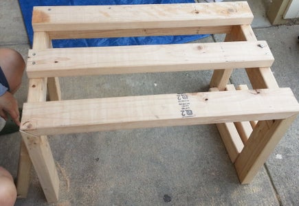

Step 2: Make the Base

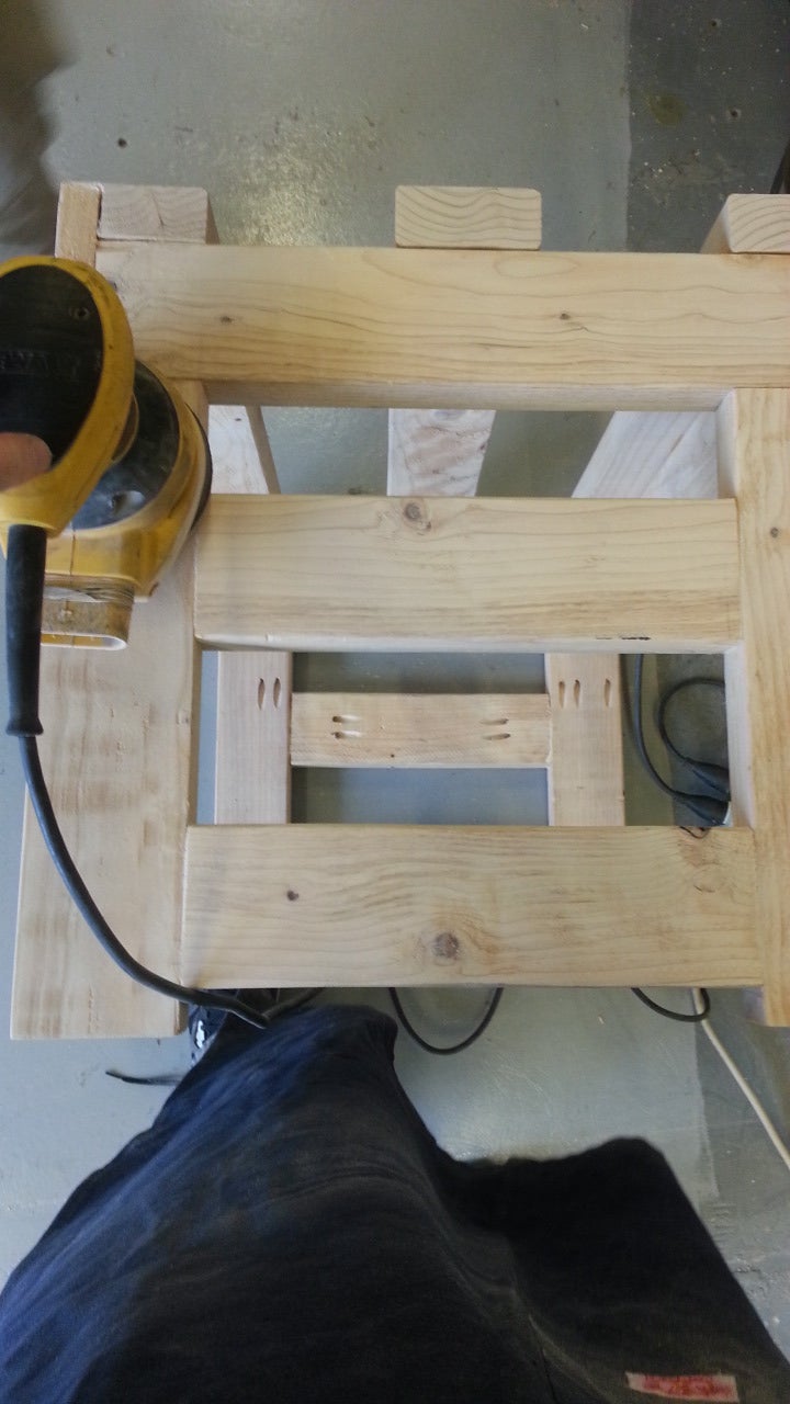

1. drill the pocket hole holes in one piece out of the two pieces you are trying to join. Insert the screws but don't drill them through yet.
2. glue both sides of the attachment point, put them together, clamp it securely. Make sure you clamp it with a 90degree clamp if possible, to ensure that it is actually 90deg.
3. drill the previously-inserted screws in, so they enter the second piece of wood
4. remove the clamps
Note that the CAD file shows some metal angled brackets underneath. I found that these were unnecessary as it was already strong enough.

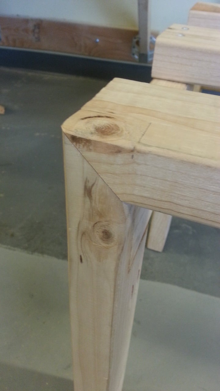

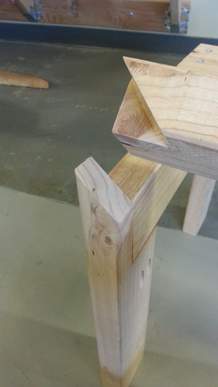

One other note is, there is one strange joint there. You will see it zoomed in and exploded in some photos in this step. Basically the reason I designed it this way is so you would never have to see the end-grain. From the front it looks like a 45degree mitered join, but from the side (which is not visible in the final assembly) it is clear that it is stronger than a 45degree mitered join because the flat side of one 2x4 is resting on the flat side of another. I actually created another separate instructable to just talk about this join -- see it here: instructables.com/____
Now just sand off the edges as shown, especially the side edges so you have a nice flat side to lay the side panels against. you have a kind of ugly looking stool! Next to cut all the paneling...

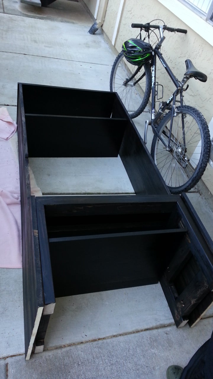

Next step is to lay it out on the floor as shown to make sure everything fits together. Then take it all home for staining/painting and assembly.

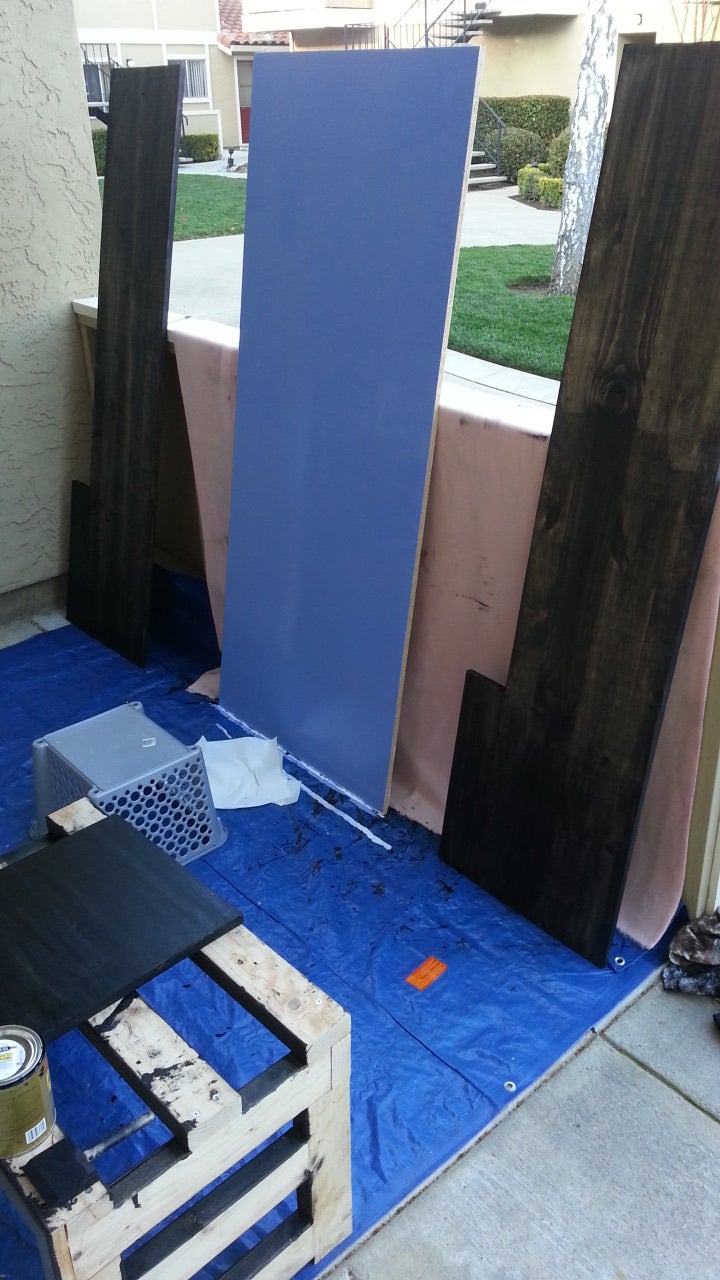

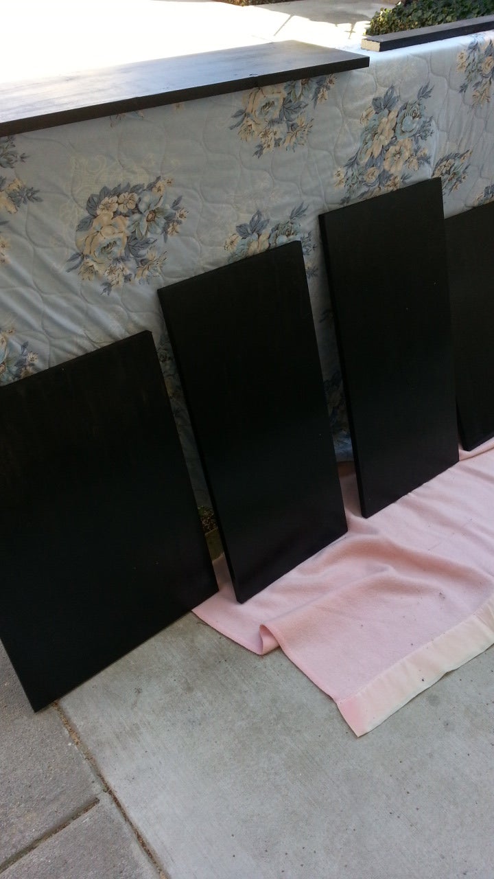

Step 4: Stain, Prime, and Paint

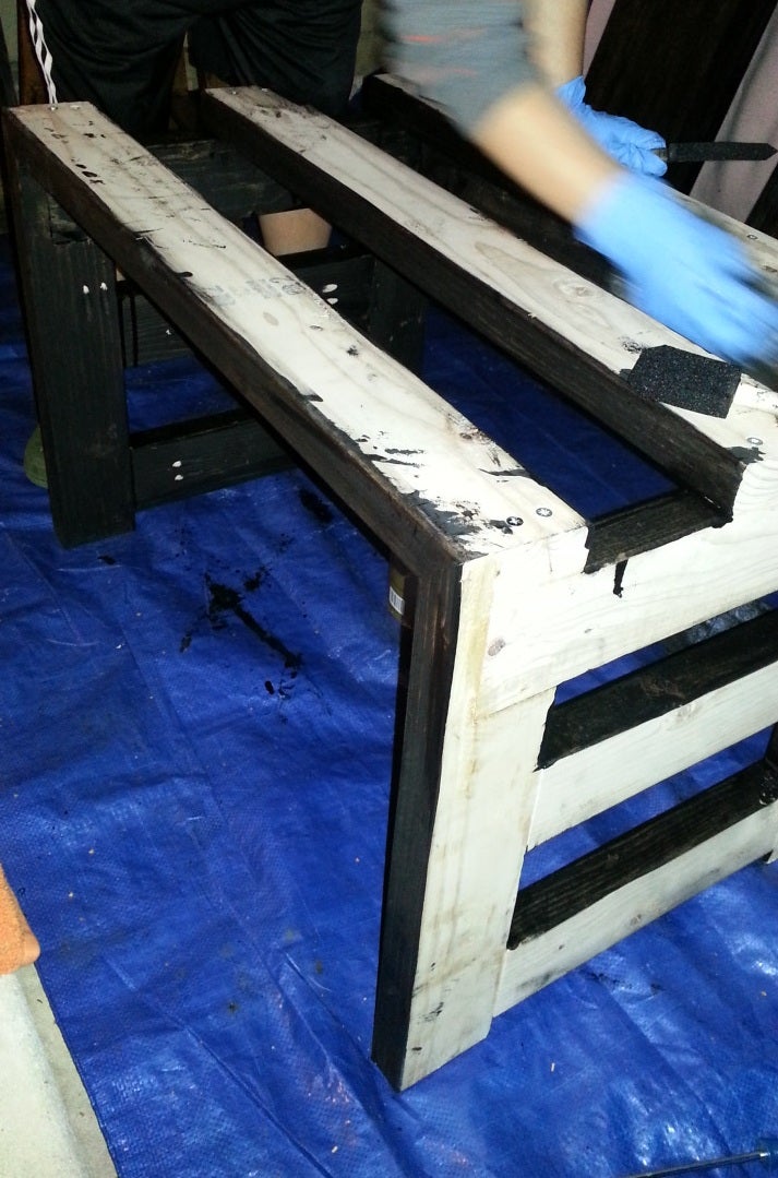

To stain, you want to first set it up outside as the fumes can be bad. Brush it all on one face at a time, wait 5-15 min (5 min in sunlight, 10 min in cloudy lighting), then wipe off the excess gently using a cloth. Wipe in the direction of the grain. Watch youtube for more videos on how to stain wood.
Note that while most of the panels are stained once, some of the panels we stained twice, on purpose, as this would give some panels the wood-like look while the others are jet black and it is hard to make out the wood-grain. See for example the top of the stool, which is lying down facing you in one of the pictures. There are two jet black panels with a stripe of single-stained panel between, which gave it a bit more originality than just being all stained the same tint.
You do not need to stain most faces of the "stool" (by stool I mean the 2x4 assembly that goes around the shoe drawers) as only the front face and inside will be visible once assembled -- I show this in a picture.

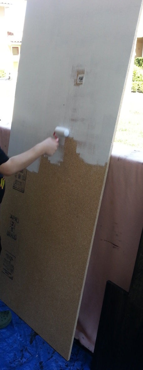

Next we wanted the back to be a bright color -- to "pop," as my wife puts it. You simply get some primer and paint it on as if it were paint. You will probably need a second coat once the first coat has dried. The point here is to cover any black marks on the wood and the primer also sinks into the wood a bit so that the paint does NOT sink in. Next you paint it. A roller gives best results without streaks. You may want a second coat of paint but we just did one.

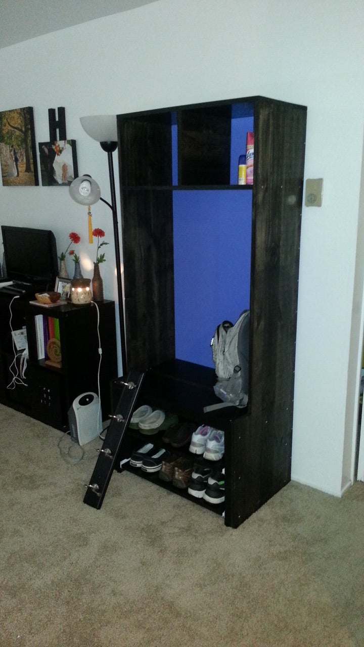

Step 5: Assemble and Done!
Last step is the assembly.
[Make sure to click "SHOW ALL ITEMS" below the pictures]

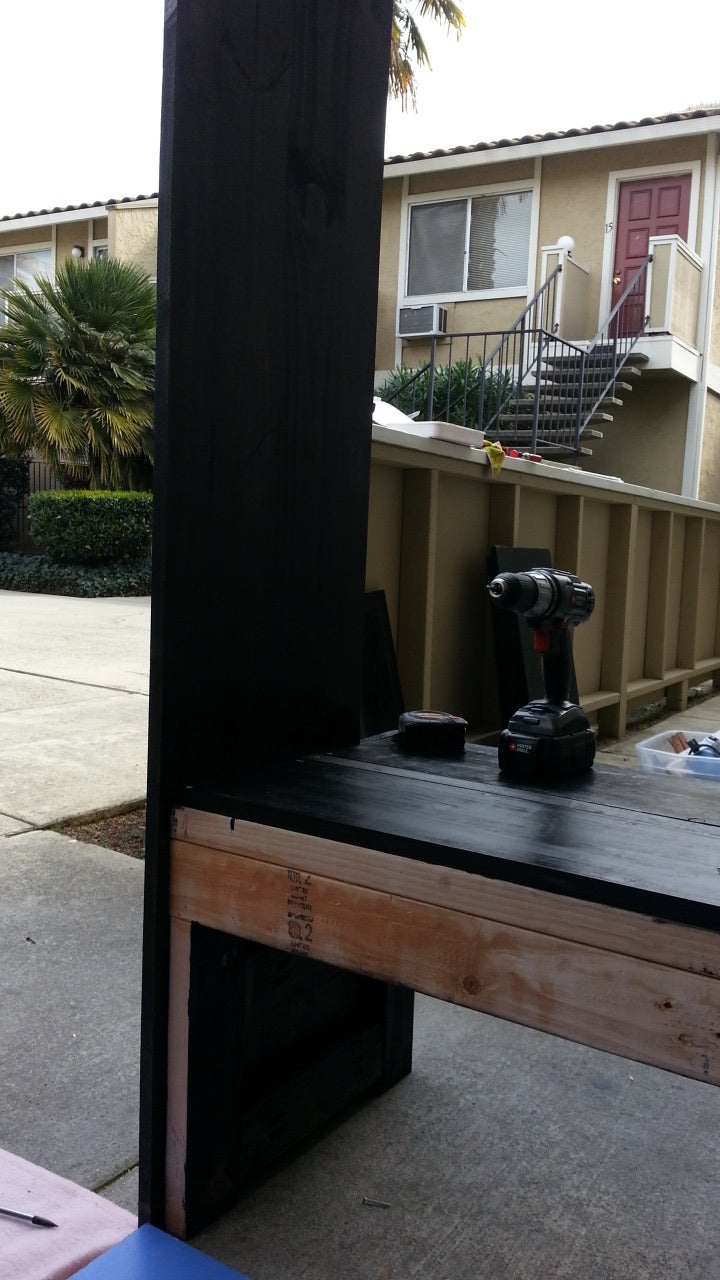

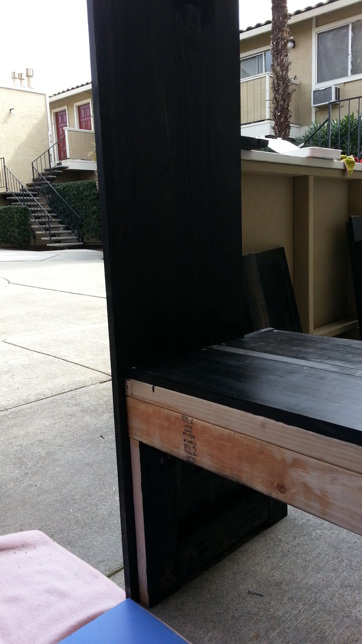

First attach the top "seat" to the "stool"

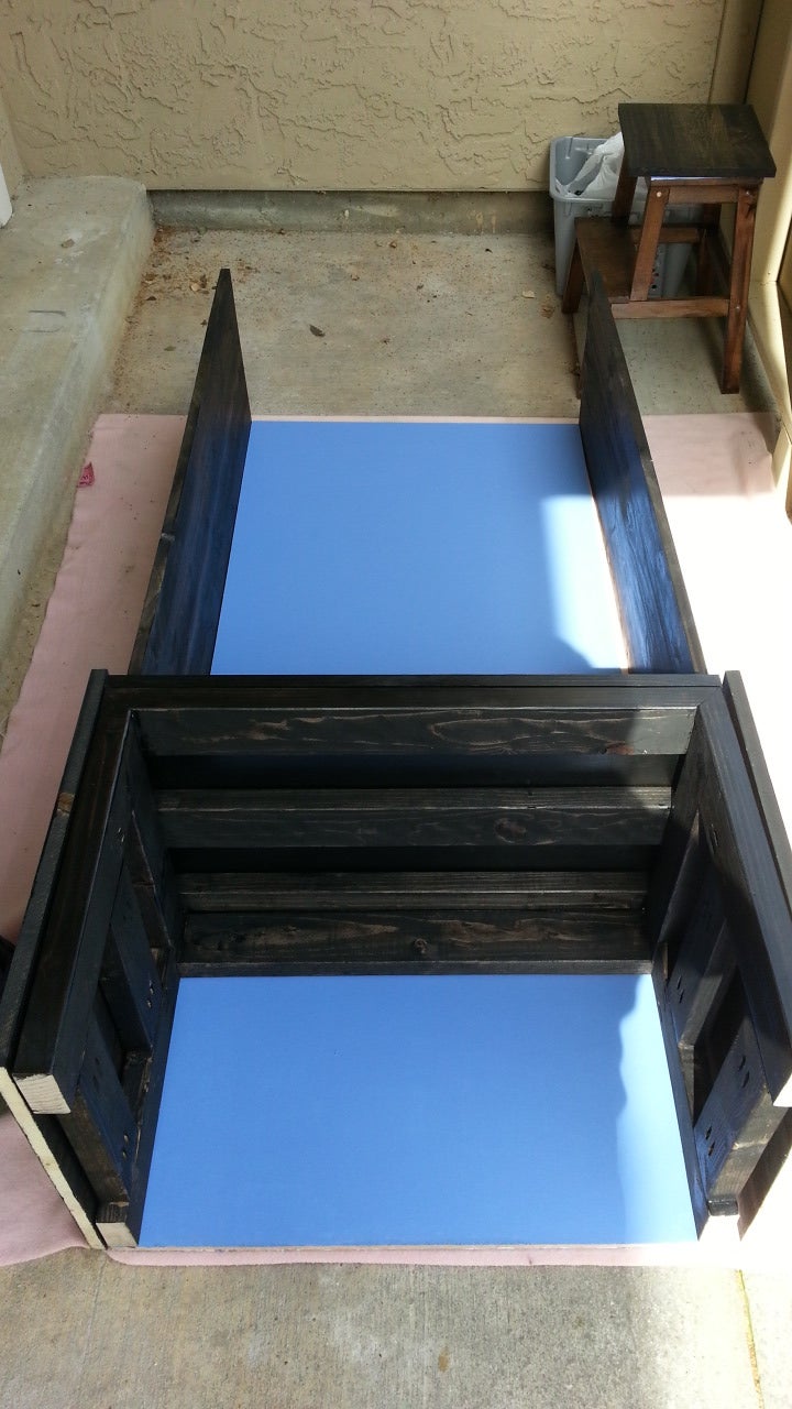

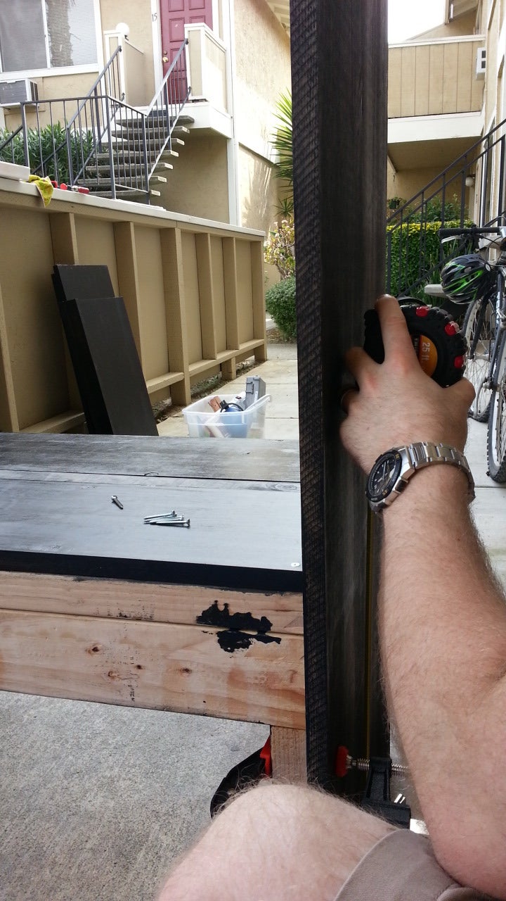

Next lay the back down on flat ground on an old blanket. Lay the "stool" on it. Lean the two sides against the stool. Now screw the two sides into the stool. (By stool I mean the strong part underneath where you sit to put your shoes on.)

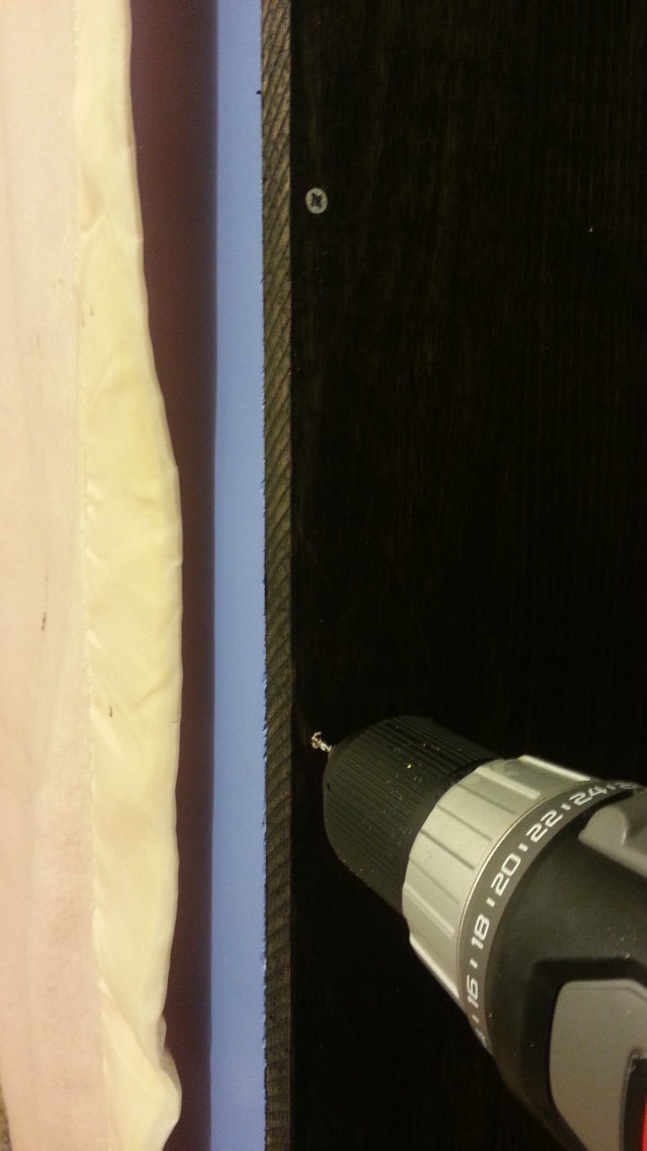

We have not attached the back yet, it's simply sitting on the back so we can align everything. Next attach the top and the top shelf, and the divider. Next, stand the whole thing up and attach the back. Note that this is the only step where more care has to be taken -- since you are screwing in to particle board, there is the risk of the particle board splitting or not holding tightly if too few screws are in. To combat this: (1) Make sure to drill your hole first, drill through both pieces so when the screw goes in it's not wedging apart the particle board but it's simply sliding in with the screw thread catching the particles; (2) Don't put a screw in closer than 2-3" from the corner of particle board. Putting one in too close to the corner can make it split at the corner; (3) Put screws in every 6", this seemed to me to be a good distance.

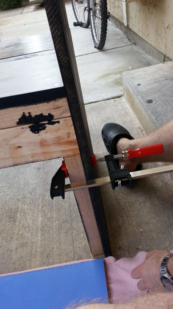

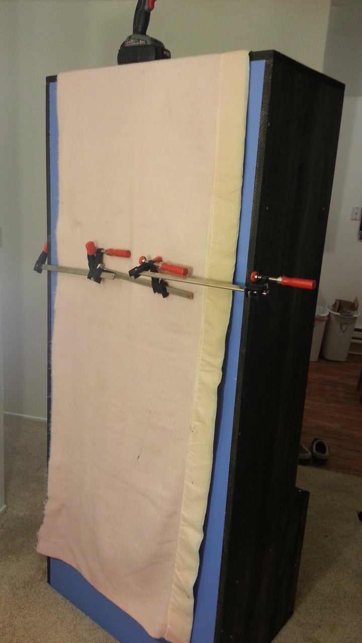

Note that some of the wood was bowed outwards, so in one of the photos I show us clamping the sides together so we could screw into the particle board. We didn't have a clamp long enough but you can improvise as shown. Worked great and now there are no gaps.
Last two items (1) Put the Euroslide runners on the sliding shoe shelf, then the complementary part on the inside of the "stool". Note that the sliding shoe shelf is designed to be 1" narrower than the opening in the front of the stool, as this is required for the particular Richelieu brand Euroslide runners (0.5" each side).
(2) attach the coat hooks as desired. We were a little concerned about the coats tearing out the hooks since the hooks would just be screwed into particle-board, so we cut another 2x4 as shown and then placed that as a cross-bar, and attached the hooks to that. Since the cross-bar is screwed not only into the back but also into the two wood sides, it is much stronger and will last a long time.
You can buy baskets from target that fit in the square holes at the top, but we haven't bought these yet.
My wife made a cushion and we found some baskets to go in the top.

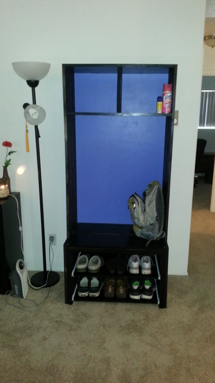

Voila, a handy place to put coats, shoes, bags, etc no more frustration for my wife!
