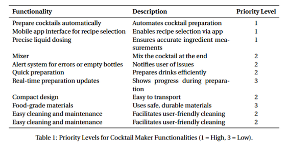

2.1 Functional analysis
The Cocktail Maker is an automated device designed to prepare cocktails quickly, precisely, and according to user preferences. Its goal is to simplify cocktail preparation while providing a user-friendly experience. It can prepare cocktails by automatically mixing ingredients, offer a variety of predefined or customizable recipes, ensure precise dosing for each ingredient, and facilitate ease of use and maintenance. Its primary function is to prepare cocktails based on a selected or customized recipe automatically. Additionally, it allows users to choose a recipe via a mobile application, provides real-time updates on the preparation status, suggests recipes based on available ingredients, and ensures easy maintenance, including cleaning and ingredient replacement. The Cocktail Maker is designed to be ergonomic with an intuitive mobile app interface, technical with precise liquid dosing, and compatible with multiple types of liquid ingredients. It also ensures safety by preventing spills or leaks. The main technical functions include pumping different liquids from bottles, measuring and dispensing precise volumes of ingredients in the glass, mixing the ingredients homogeneously with a mixer. Additionally, it can detect liquid levels in the bottles, identify the presence of a glass on the tray, offer initial calibration for accuracy, and alert the user in case of errors or missing ingredients.

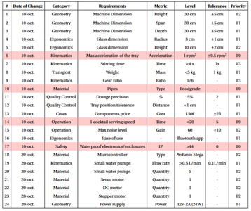

2.2 Requirements list
As can be seen on Table 2, some of the higher priority requirements were highlighted
Main(F0) priorities justification
• Max acceleration of the tray, this is important because a too large acceleration could lead the glass to fall over or the contents to spill out. This problem has been tackled by making a smooth acceleration curve on the stepper motor that controls the movement of the tray.
• Pipes food grade, obvious requirement for a cocktail-making machine since the liquids will flow through the pipes.
• The cocktail serving speed is related to the acceleration and speed curves of the servo motor controlling the tray but also the pumps speed. Pumps with a good flow rate have been chosen in order to accommodate this constraint. The acceleration and speed curves of the tray have been tested to find a good compromise between glass safety and rotating speed.
• Waterproof electronics / enclosures : since the device will handle fluids, it is mandatory that the electronics are well protected and that the materials are made out of water-resistant components. Cables are protected by external pipes and the electronic components are put on top of the machine and protected by a case.
Other constraints
• The machine dimensions should be chosen to be big enough to handle all the connected bottles but should also be transportable. Its height in particular should at least be superior to typical glass height.
• the weight of the device will only impact its transportability, it should be quite easy to carry for an average adult.
• Tray precision, the stepper motor moving the tray should be precise enough to allow exact control of the glass under the pipes.
• A maximum noise level: a too loud device would prevent people from pleasantly talking to each other. Silent components have been chosen, in particular for the stepper motor and the pumps.
• The ease of use of the machine plays an important role in the customer’s ability to order easily.

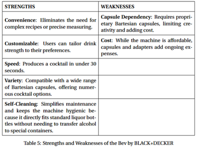

3.2.3 The Bev by BLACK+DECKER
The Bev by BLACK+DECKER [2] is a user-friendly cocktail-making appliance designed to simplify the preparation of cocktails while delivering professional-quality drinks at home. Its intuitive design and functionality make it an appealing option for individuals who enjoy cocktails but don’t want to deal with the complexities of traditional bartending.

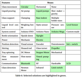

4.1 Morphological Chart
The following morphological chart presents potential solutions for each of the technical challenges described above.
4.2 Analysis of Solutions
4.2.1 Liquid Control and Dispensing
Different methods for measuring and dispensing liquids were considered. For measurement, optical sensors offer simplicity but can be unreliable with varying liquid clarity. Pressure sensors provide accurate readings but add a level of complexity that is undesired. Conductivity measurements vary significantly between different liquids. Level sensors emerged as optimal, providing direct and reliable measurement regardless of the type of liquid. For dispensing the drinks, we strongly considered air pumps which are simple, however, they lack precision for small volumes which is largely the operating point for this cocktail maker. Gravitybased systems, while cost-effective, cannot ensure consistent flow rates and offer very little chance of being controllable. Liquid pumps, though more expensive, provide the necessary precision and flow control required for accurate drink preparation. Flow measurement can be handled through either flow meters or timed pumping. While flow meters offer direct measurement, timed pumping with characterized pumps provides sufficient accuracy with fewer components and reduced maintenance needs.
4.2.2 System Architecture and Power
The best and most cost-effective controllers in the market are of the Arduino brand, and while they offer ideal solutions, they have limitations when it comes to being used in the cocktail maker. For instance, the Arduino UNO lacks sufficient I/O ports, while the Nano’s processing power is limited. To this effect, the best solution is to develop a custom-made system, which, despite higher initial complexity, provides complete control over features and future expandability. Bottle orientation significantly impacts system reliability. Upside-down orientation risks leakage and complicates refilling. An upright orientation simplifies maintenance and reduces failure points, therefore, this option was selected for the design. For power supply, mechanical solutions would require complex transmission systems and introduce multiple failure points. Electric power provides reliable, consistent operation necessary for precise control of pumps, motors, and sensors while being more energy-efficient and easier to implement safety features.
4.2.3 Movement and Detection
For tray position detection, visual sensors are complex and environment-dependent. Encoders provide excessive precision at a higher cost. A simple init + switch system provides reliable positioning while minimizing complexity. Glass detection methods vary in reliability. Newton meters add unnecessary complexity, while infrared sensors can be affected by ambient light and liquid spillage. Limit switches provide straightforward, reliable detection regardless of environmental conditions.
4.2.4 Mixing and Motion Control
For stirring mechanisms, unaxed stirring rods risk glass contact and potential breakage. Glass turners require complex mechanical systems prone to failure. A propeller system offers effective mixing while maintaining simplicity, with controlled agitation that works across different drink types and volumes. Tray spinning requires precise control for glass positioning. DC motors, while cost-effective, lack the necessary positioning accuracy. Mechanical systems introduce maintenance concerns and wear points. Stepper motors provide the optimal balance, offering precise positioning and holding torque with reliable operation.
4.2.5 User Interface and Communication
Bluetooth connectivity allows for a variety of options including smartphones, laptops, and tablets. Bluetooth is also relatively easy to configure. RF systems risk interference in busy environments. Hard cable connections limit portability and increase maintenance points. An LCD interface provides direct visual feedback and menu access without relying on external devices. Both Bluetooth and LCD display are ideal for this system. This dual-interface approach provides flexibility for different use cases. The LCD ensures the system remains operable as a standalone unit, while Bluetooth connectivity enables enhanced features like remote control, drink customization, and system monitoring.
4.2.6 Glass Support and Safety
For glass support, clamping mechanisms risk glass damage and increase complexity. Multiple holder sizes require more space and parts. Base indents provide a simple, effective solution that accommodates various glass sizes while ensuring stability during operation. These analyses led to the selection of solutions that optimize reliability, precision, and maintainability while keeping system complexity manageable. From these chosen solutions, we can now develop complete system concepts.

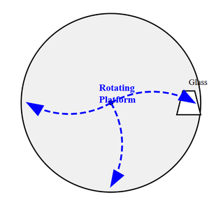

4.3.1 Concept 1: Rotating Platform System
This concept utilizes circular movement with a rotating platform. If the goal was to maximize precision and reliability while maintaining good user interaction, this concept would be ideal. The circular motion simplifies control while fixed dispensing stations ensure consistent drink preparation. The system also provides flexibility through its dual interface system, making it suitable for various use cases from home bars to commercial settings.
• Circular tray with base indents for glass positioning
• Fixed liquid pumps mounted above
• Stepper motor for precise platform rotation
• Integrated propeller mixing system that lowers into glass
• LCD interface mounted on front panel, with Bluetooth connectivity
• Level sensors in each bottle
• Custom control system managing all operations

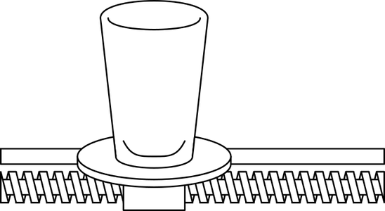

4.3.2 Concept 2: Linear Track Design
This concept employs horizontal glass movement with a linear track system. If the goal was to reduce development time and make the overall structure more compact, then this concept would be more than ideal. We would also reduce the time taken to make a drink as it relies on a gravity-fed dispensing system.
• Glass moves on linear rail between dispensing stations
• Gravity-fed dispensing system with shot makers
• Multiple holder sizes to accommodate different glasses
• Mechanical mixing through glass rotation
• Pressure sensors for liquid level monitoring
• Arduino Mega control system
• RF communication interface
• DC motor drive system

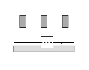

4.3.3 Concept 3: Static Station Design
This concept eliminates glass movement in favor of a fixed position system. If the goal was to minimize mechanical complexity and reduce potential failure points while keeping costs low, this would be the preferred solution. The static design also allows for a more compact form factor, making it suitable for spaces where footprint is a primary concern.
• Fixed glass position
• Moving dispensing head with multiple nozzles
• Air pump dispensing system
• Clamping mechanism for glass security
• Optical sensors for liquid monitoring
• Simple Arduino UNO control
• Hardwired interface
• Unaxed stirring rod for mixing

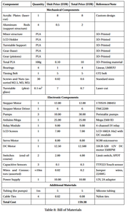

6.1.1-6.1.2 : Please refer to the first picture.

6.1.4 Rotating Tray
The purpose of the tray is to bring the glass at the correct position. It must do without spilling the glass while not being too slow either. We determined experimentally that an acceleration of π/2 rad/s² (with the glass at 10 cm from the center) was giving good results, without taking any risks. To have enough room for the pumps and the mixer, we decided that the distance between the center of the glass and the axis of rotation would be 10 cm. In addition, it must be precise enough to avoid the ingredients being dispensed beside the glass and for the mixer to be well positioned. We chose in our requirements a precision of 1 cm which, with our 10 cm, gives an angular resolution of 1/10 rad or 5.73 deg. For the mechanism itself, we first thought about planetary gears. However, we quickly switched to bevel gears in order to gain space by putting the motor horizontally and avoid the backlash caused by the additional gear in the gear train. The main idea is to have a large crown gear fixed on the bottom of the tray and the pinion fixed on the motor. To ensure the horizontality of the tray, it is supported by four small wheels. Originally, we planned on 3D printing the crown gear in 4 parts that would connect while screwed to the tray. However, we later updated the design to have a slightly smaller gear that could be printed in one piece. The straight bevel gears were also changed for helical bevel gears to smooth the motion as much as possible. To make sure the teeth of the gears wouldn’t break, we computed their minimum face width. We can get the maximum stress σ in the tooth from the Lewis formula [3]:
σ = Wt*π/(pF Y) (1)
where Wt is the tangential tooth load [N], p is the circular pitch [m], F is the face width of the tooth [m] and Y is the Lewis shape factor [−]. This formula is made for cylindrical gears but due to the chosen gear ratio of 6, our gears are very close to a rack and pinion so we considered it valid in our case. To avoid gear interference, we had to put 16 teeth on the pinion. To have enough room for the stepper under the tray, the radius chosen for the pinion was roughly 20 mm which lead to a circular pitch of 7 mm. Rearranging this equation and looking for the minimum F for a maximum σ and a maximum Wt :
Fmin = Wt,max*π/(p*σmax*Y) (2)
The tangential stress depends on the torque of the motor T in the following way :
Wt = 2T/dp (3)
where dp is the pitch diameter of the pinion. Considering the maximum torque our motor is able to produce and the maximum tensile strength of 3D printed PLA in the direction normal to the layers (which is around 30 MPa [4]), We finally get :
Fmin = 2*Tmax*π/(p*σmax*Y*dp)
= 2 · 59 · 10−2π/(7 · 10−3 · 35 · 106 · 0.295 · 16 · 10−3)
= 3.74mm
A tooth width of 4 mm should thus be enough. However, since we made some approximations and in order to have a more robust gear, we chose to triple that number and used a tooth width of 12mm

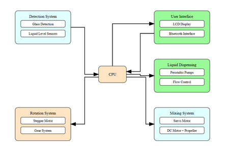

Step 8: Subsystem Design(Circuitry and Sensors)
6.2.1 Microcontroller
To control the actuators and collect data from the sensors, we use an Arduino Mega 2560. This Arduino is necessary for our prototype because it contains many more pins than a UNO. In the end, our prototype contains a huge number of subsystems, including specific pins requested as communication pins for the Bluetooth module or the LCD screen, as well as numerous analog pins for liquid sensors, pumps, various motors, switches, and drivers.

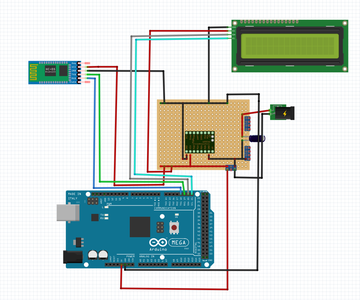

6.2.3 Stepper motor
In this system, the stepper motor, controlled via the AccelStepper library, is used to rotate a platform to specific positions. It manages to put the glass under the pumps and mixer’s position. It contains:
• 1 Stepperonline 202203101837 stepper motor
• 1 TMC 2209 driver for stepper motor
• 2 switch button
• 1 capacitor of 220μF
The AccelStepper library provides significant flexibility in controlling the stepper motor, allowing the platform to rotate in any direction, clockwise or counterclockwise, depending on the required task. It can also precisely control the rotation of the platform for the exact number of steps required to achieve a specific angle. In this system, one full revolution of the stepper motor corresponds to 1600 steps. However, due to the gear ratio of 6 in our setup, one full rotation of the platform requires 6 complete rotations of the stepper motor. This means that a complete revolution of the platform equals 9600 steps.
To guarantee accuracy and consistency, the platform’s initial position must be calibrated at the start of the operation. This is achieved using a switch strategically placed underneath the platform. The switch is positioned in a way that it gets activated whenever the glass support moves over it. During the initialization phase, the platform begins to rotate until the switch is triggered. At this moment, the system recognizes the current position of the stepper motor as the starting reference point, or step 0. The second switch will detect if the user placed their glass on the tray before taking their command.

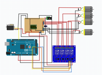

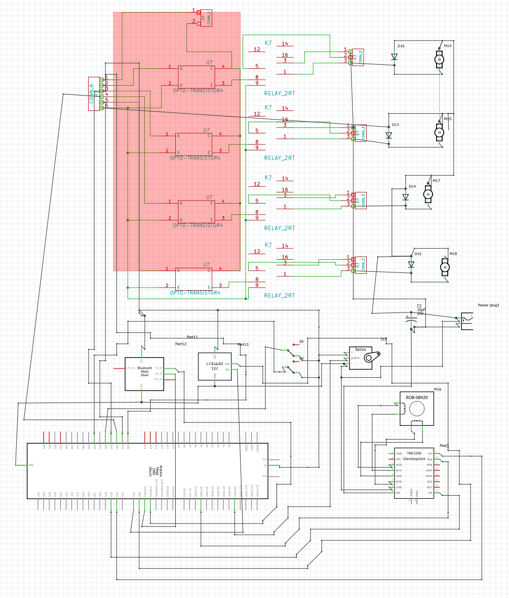

6.2.4 Pumps and Mixer power supply
The purpose of this system is pouring the good liquid in the glass and mix the cocktail. To reach this objective: we need electronic components below:
• 3 peristaltic pumps
• 1 DC motor
• 1 4 channel DC 5V Relay
• 1 continuous rotation Servomotor
• 4 flyback diodes
The pumps and the DC motor of the mixer are connected to the relay in order to more easilymanage their activation and deactivation, the Pin + is connected to the first input of each relay, the Pin - is connected to the ground of the power supply and the power supply is connected at the second input of each relay. Then the pins of the Arduino controlling the pumps/motors are connected from the Arduino to the init 1,2,3,4 pins of the relay, and the VCC and GND pins are the power supply and the ground of the Arduino, the servo, when is connected directly to the Dc of the Arduino, to its ground as well as to the PWM pin which controls it. The pumps and the dc motor need a 12V alimentation and the servo need the 5V alimentation from the Arduino.
6.2.5 LCD system and Bluetooth module
The LCD gives a little graphic interface to choose the cocktail. The LCD model is a LCD 1602A 16x2 with I2C module to use less pins and simplify the circuitry. It is connected to the VCC and GND of the Arduino and to the special communication pins of the Arduino SLA and SCL. The Bluetooth module permits son send information from the sensors to the phone and receive the command from the phone’s user. It is connected to the VCC and GND of the Arduino and to the communication pins which correspond to it, the RX and the TX.
6.2.6 PCB
To make our circuit more solid, better ordered and more aesthetic, we decided to print part of it on a PCB, we connected all the power sources, its masses as well as the voltage coming from the Arduino. and its mass. We also took the opportunity to solder the capacity and the driver of the stepper motor in order to make their connections clearer and to limit their bulk.

void setup()
Serial.begin(9600);
Serial1.begin(38400);
lcd.init();
pinMode(pump1Pin,OUTPUT);
pinMode(pump2Pin, OUTPUT);
pinMode(pump3Pin, OUTPUT);
pinMode(activateStep, OUTPUT);
digitalWrite(activateStep, LOW);
digitalWrite(pump1Pin, HIGH);
digitalWrite(pump2Pin, HIGH);
digitalWrite(pump3Pin, HIGH);
digitalWrite(DCmixPin ,HIGH);
myServo.attach(9);
pinMode(initPin, INPUT_PULLUP);
pinMode(DCmixPin,OUTPUT);
stepper.setMaxSpeed(MAX_SPEED);
stepper.setAcceleration(ACCELERATION);

Step 14: Bill of Materials

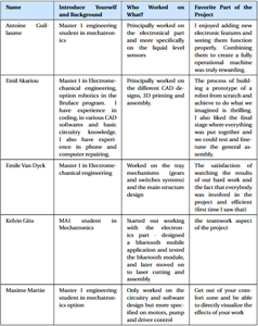

About the Team
Who We Are: We are a group of passionate students at the EPB who love robotics and cocktails. That’s why we chose to combine these two interests into our exciting project. When we started, most of us barely knew each other or didn’t know each other at all. This project has been an incredible opportunity to bond and grow as a team, creating strong connections.
