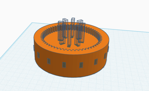

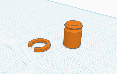

Step 2: TinkerCad
I used the information about my planetary gears setup that I gathered on Gear Generator to design my Cocoa Cooler. For this project I am using TinkerCad which has a really useful gear generation tool. I started by generating all of my gears by entering the teeth amounts and teeth pitches into the generating tool. The ring gear in planetary gears, is an internal gear. This means it is basically a negative cutout of a gear. By knowing this, I could just generate a normal gear, and then use it to cut a circle. For this project, I also designed a clipping axle system which became very helpful for repetitive connections. I added some cutouts into the body to act as ventilation holes, to help with the cooling process. The holes above the fan are intakes and the holes going out the sides is the exhaust for the steam of the drink. Lastly, I modeled some simple fan blades by modeling a single blade and duplicating it every 45 degrees.
Cocoa Cooler

Step 4: Assemble Carrier
Insert the three planet gears into the carrier. Then secure each of them with a clip. Each gear should be able to spin pretty freely. I did not need to, but you may need to sand a little bit to open up some tolerances.
