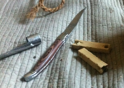

For this project I used the following tools and Items:
- Safety glasses
- Dremel 200 with a cut off wheel accessory
- pencil
- Automatic Screwdriver with corkscrew drill bit
- Vice Grip twist-clamp
- Knife, apple core tool
- Water [and soap]
- Dehusked coconut in shell (Cocos nucidera seed)
- Large cup (to collect coconut water)
- Coir Coconut Rope/String (Warning: do not use treated rope or twine as it may be poisonous to animals, if it smells like chemicals or oil, do not use it. I bought my coir on eBay 20ft at a time, it's not expensive at all.)
- natural plant raffia [for nesting material]
- Optional: Wood block cut to 3"x.75"x.75" inch strips
- bandaid [use as needed]
