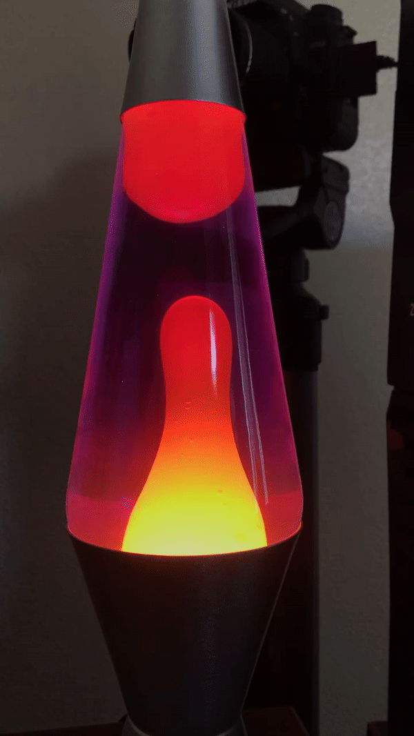

Step 1: Observe the Lava Lamp
If you have a physical lava lamp, I encourage you to turn it on and spend a while observing it. There are a few characteristics I'll explicitly teach you how to emulate, but I encourage you to add more and experiment with it! Otherwise (for now), check out some footage.
Here are a few things to note:
- The blobs often merge when they collide to form a single blob.
- When alone, the blobs become more spherical.
- The blobs tend to move quickly from the top to the bottom or vice versa, slow down when they reach their destination, then eventually switch sides quickly again.
- The color of the blobs tends to be brighter at the bottom and darker at the top, since the light source is at the bottom and the liquid and other blobs can block the light.
- The alcohol/water solution, if colorful, seems darker toward the edges of the lamp.
We're going to specifically target these features of lava lamps. What others have you noticed?
- Example: sometimes, the blobs "overlap" or collide with each other. Our lava lamp will be flat. How can you achieve this?

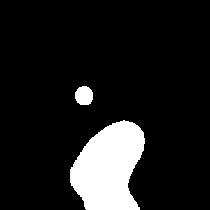

Step 4: Create the First Blobs (Metaball-like)
Here's our approach for creating the basic, black-and-white blobs:
- Set the color to black.
- Create a list of vec3s containing 3 numbers: x and y positions on the Sprite representing the center of each blob, and the "strength" that that blob has to influence nearby points (we can think of this as roughly analogous to the blob's size).
- Create a number (call it "influence") (starting at 0) that will represent how much this point is influenced by the blobs.
- For each point processed by the fragment function, we'll calculate its distance from each of the blob positions.
- Based on how close it is to each blob position, we'll add a multiple of that blob position's "strength" to "influence". (This multiple should be larger when the distance is smaller!)
- If "influence" is above a certain threshold, say, 1.0, set the color to white.
Let's start with two blobs:

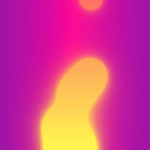

Step 6: Add Some Color (Gradients and Glow)
In this step, we'll add some gradients to the color of our blobs, and we'll change the background color from black to a color more fitting for lava lamp liquid, again in gradient form. I'll copy the lava lamp colors from the one I observed at the beginning of the Instructable, but again, I really encourage you to play with the colors and try a bunch of combinations!
Here's the general approach for how this is going to work:
- At each fragment, if this is not a fragment on a blob (i.e.) we've assigned its color black, instead assign its color to a linear interpolation between two colors, or a mix between two colors, using this fragment's x-distance from the center of the lamp to determine which of each color to use.
- Similarly, if this is a blob fragment, instead assign its color to a linear interpolation between two colors, or a mix between two colors, using this fragment's y-value relative to the whole Sprite.
- Add a second, smaller threshold to measure where the glow should be (around each blob), and mix colors between this blob's y-color at this point and the background (non-blob) color at this point using the threshold to create the ratio.
This is also a stage where you have a lot of freedom to tweak the various inputs to dramatically change the outcomes.
First, let's define a few uniforms. Uniforms are outside input from the engine, and adding them makes it possible to change the values (like colors, blob size, speed, etc.) from the editor or from code. Since we can use the editor's color picker, they also make customization easier! Adding "hint_color", for example, tells the editor this input is a color and allows us to use its built-in color picker, instead of having to rely on our knowledge of RGBA.
uniform float blob_threshold = 1.0; uniform vec4 background_edge: hint_color = vec4(1.0, 0, 0.6, 1.0); uniform vec4 background_center: hint_color = vec4(0.4, 0, 1.0, 0.4); uniform vec4 blob_top: hint_color = vec4(1.0, 0.4, 0.4, 1.0); uniform vec4 blob_bottom: hint_color = vec4(1.0, 1.0, 0.3, 1.0);
Here's the finished code for this step (note that I changed the strength of each blob and tweaked influence as well!)

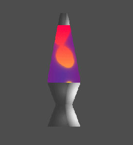

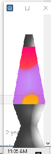

Step 7: Apply a Base
In this step, we'll switch from overwriting the basic Godot icon to using a PNG of a lava lamp base. You're welcome to use my lava lamp base image or create your own; what's important about the image is that you know the exact color of the region to replace with the shader we've created so that we can replace that color with our shader. I created mine using Blender.
Here's our general approach:
- Replace the Godot icon with the lava lamp base, keeping track of the color to replace with the globe shader.
- When you import the base image, it's very important that you disable filtering from the "Import" tab.
- In our shader, if the COLOR is exactly equal to the color we want to replace, continue with our existing code. Otherwise, use the color defined by the texture at this point.
- Adjust our functions and gradients to account for the fact that 1.0 no longer represents the top of the globe, and 0.0 no longer represents the bottom of it.
Here's our finished shader code!

blob_centers[3] = vec3(0.4, oscillate(TIME, 0.1, 0.1), 30.0);
blob_centers[4] = vec3(0.5, oscillate(TIME, 0.4, 0.1), 50.0);
blob_centers[5] = vec3(0.6, oscillate(TIME, 0.3, 0.2), 30.0);
// start counting influence at 0
float influence = 0.0;
// for each of the blobs, we add some influence based on how close
// this point is to each blob
for (int i = 0; i < blob_centers.length(); i++) {
// TODO: explain each of these variables
float distance_to_blob_center = distance(blob_centers[i].xy / TEXTURE_PIXEL_SIZE, UV / TEXTURE_PIXEL_SIZE);
influence += blob_centers[i].z * (1.0 / distance_to_blob_center);
// if influence is larger than a certain threshold, set the color at this
// point to the gradient
COLOR = mix(background_color_here, mix(blob_top, blob_bottom, (UV.y - top) / (bottom - top)), pow(influence, 6));
if (influence > blob_threshold) {
COLOR = mix(blob_top, blob_bottom, (UV.y - top) / (bottom - top));
Step 8: Bonus! Keep Your Lava Lamp on Your Desktop or Screen
I like to keep my lava lamp in the bottom right corner of my screen. It's a nice little widget for mild entertainment while I'm working. The Godot Game Engine provides everything we need to achieve this!
In the top left corner of the engine, pick "Project" > "Project Settings" then scroll down to "Display" > "Window". Adjust the size of the window to the size (in pixels) you want your lava lamp to be.
While in "Project Settings" > "Window", tick "Always on Top", and allow and enable per pixel transparency. Then, add a script to your Game scene with the following code:
func _ready(): get_tree().get_root().set_transparent_background(true)
Close out of the project settings. You'll notice the blue box representing the size of the game window has updated. Using the lower right-hand corner and shift, scale your Sprite to match the box.
To change where the window appears on your screen, navigate to "Editor" > "Editor Settings", then scroll to "Run" > "Window Placement", set "Rect" to "Custom Position" and set "Rect Custom Position" to your screen size minus your lava lamp size.
Then press the Play icon to bring up your lava lamp! You can keep it on top of your work and drag it around if i gets in the way.
