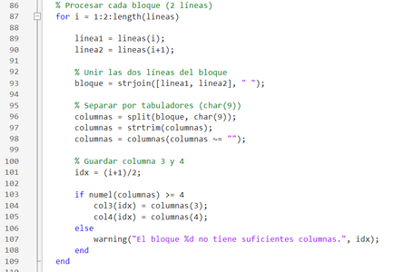

Step 1: Getting the Notes
First, we have to get the notes out of all the information that Biblioteca Nacional de España has in store for each chant. Using the previous algorithm, we only have the codified notes in the variable textoTotal.

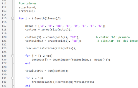

Step 2: Creating the Database
Next, we create the histogram of the amount of appearances each note has in each mode, as well as each note's frequency. To do this it is necessary to search the Bb first so that they don't get confused with the B.

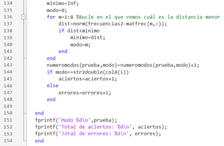

Step 4: Calculating the Mode
Once we have each chant's codified incipit and real mode, now we calculate each note's frequency and we get the distance between that vector and each mode's corresponding vector, and establishing that the mode with the least distance is the correct mode. Then we compare this guessed mode with the real one.

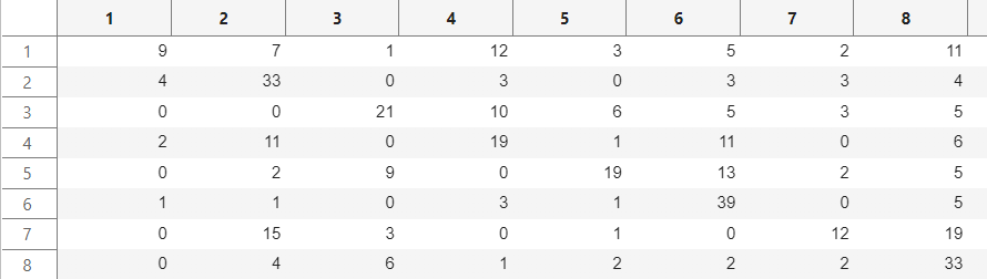

Step 5: Results
Lastly, we take a look at the results. By doing this we see that the method has big room for improvement, but also it is right a decent amount of times. More importantly, it is noticeable that the performance depends on the mode, with modes 2, 6 and 8 yielding pretty good results, 3, 4 and 5 somewhat mixed results, and modes 1 and 7 with really bad results.
Improvements like taking the duration of the notes or the first note of each chant into account, as well as researching more sophisticated ways to calculate the most similar mode to each chant are due. In the meantime, this method can be a decent place to start.
