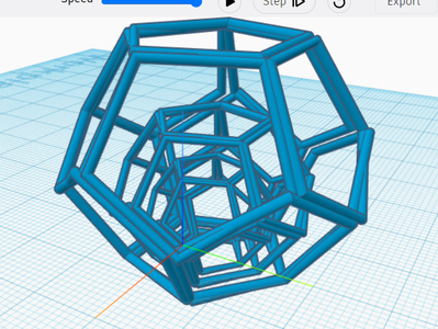

Introduction: CodeBlocks Fidget
In this tutorial I will show you how to make a 3D printed fidget in Block Code. Each shape moves independently and does not make noise while fidgeting.

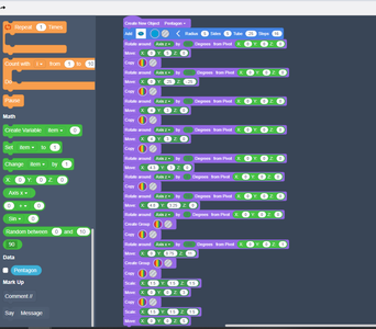

Step 1: 1. Write Your Block Code in TinkerCad
Go to TinkerCad and on the left hand side click on CodeBlocks. Then click on new to start a new blank project.

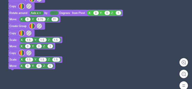

I started by making one shape and then used the code to adjust and make one large shape. Then you copy the shape and make it larger each time. This will produce a single 3D print and when you remove from the raft you have a working fidget.
