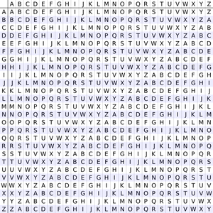

First, write out your message in normal print. This is called the plaintext. Next, write out your keyword (in this case the keyword is IBLES) above or below your plain-text. Make sure your plaintext letters and your keyword letters match. I placed the key above the plaintext in my example. After this has been done, pull out your Tabula Recta (or Vigenére Square) and use it like a grid. Since "I" is the first letter of the keyword, it will be used first. The corresponding letter of the plaintext, in this example, is "S". Go to the top of the Vigenére Square and find "S" follow the "S" column down until you get to the "I" column. Where the two columns intersect there will be a single letter. The is the first letter of our ciphertext. Repeat this process until all of the plaintext and key letters have been changed into ciphertext letters.

To decrypt a Vigenére cipher, simply find the first letter of the key in the Tabula Recta and follow its row or column until you come to a letter matching the corresponding ciphertext letter. In my illustration, the first letter of my key is "I" and the first letter of my ciphertext is "A." So, I follow the "I" column until I come to an A. After I find the "A" I trace it up to the top of the Tabula Recta until I find the last row. Whichever letter I land on is the first letter of the ciphertext. (Refer to picture 2)
