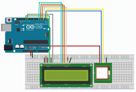

Step 3: Connect the Components
Now, let's bring your Community Stories Explorer Kit to life by connecting the GPS module, MP3 Player Shield, and LCD screen to the Arduino Mega. Ensure you have a half-size breadboard to mount the LCD screen. Follow the detailed connections below:
GPS Module:
  • GND: Connect to GND on Arduino Mega.
  • 3V3: Connect to 3.3V on Arduino Mega.
  • SDA: Connect to SDA on Arduino Mega.
  • SCL: Connect to SCL on Arduino Mega.
MP3 Player Shield:
  • 5V: Connect to 5V on Arduino Mega.
  • 2 MP3-DREQ to Digital 2
  • 6 MP3-CS to Digital 6
  • 7 MP3-DCS to Digital 7
  • 8 MP3-RST to Digital 8
  • 9 SD-CS to Digital 53
  • 11 to Digital 51
  • 12 to Digital 50
  • 13 to Digital 52

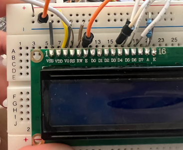

LCD Screen (Mount on Breadboard):
  • VSS (Ground): Connect to GND (-).
  • VDD (Power): Connect to Power (+).
  • V0 to GND (-).
  • RS to Digital Pin 12.
  • RW to GND (-).
  • E to Digital Pin 11.
  • D4 to Digital Pin 10.
  • D5 to Digital Pin 9.
  • D6 to Digital Pin 5.
  • D7 to Digital Pin 3.
  • A goes to a resistor to power (+).
  • K goes to GND (-).
Double-check each connection to ensure accuracy and security. I looked at this resource as well while setting all of this up. This step lays the foundation for seamless communication between the components, setting the stage for the interactive exploration that awaits with the Community Stories Explorer Kit. Once the connections are verified, you're ready to proceed to the next exciting phase of programming your device!

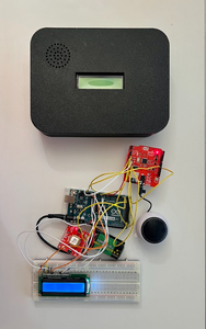

Step 6: Sharing Your Geo-caching Device
Congratulations on successfully testing your Community Stories Explorer Kit! Now, let's prepare it for the hands of an eager explorer. Follow these steps to enclose all the components and pass on the device:
  1. Secure Components:
  2. Use tape, glue, or other appropriate fasteners to secure the GPS module, MP3 Player Shield, Arduino Mega, and associated wires in a tidy and secure manner.
  3. Protect the Breadboard:
  4. If using a breadboard for the LCD screen, consider securing it within a protective enclosure to prevent accidental disconnections or damage.
  5. Secure the SD Card:
  6. Ensure the SD card is securely inserted into the MP3 Player Shield.
  7. Provide Clear Instructions:
  8. Prepare a simple set of instructions for the next explorer, explaining how to use the device and encouraging them to discover the city through the programmed locations.
  9. You may want to give them a list of the locations they'll need to go to.
  10. Enclosure Options:
  11. Consider placing the components inside a weather-resistant enclosure or case to protect them from environmental factors.
  12. Handoff and Share:
  13. Hand over the Community Stories Explorer Kit to someone else, perhaps a friend, family member, or community member.
  14. Encourage them to embark on the geo-caching journey, discovering the city through your stories and contributing their own.
