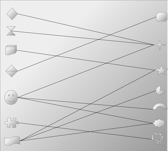

Step 1: Pairwise Connections in Perl - Methods
Consider the following example:

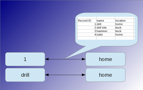

Telephone books provide an alphabetically ordered list of names, allowing the reader to find what phone number is assigned to a person. There is also such a thing as a "reverse directory" which allows one to start with the phone number and get the name of the person associated with that number. (Handy when you want to find out who is interrupting your dinner!).
Now the problem, let's say you are working with a data source that does not guarantee 1-1 associations. An example of this would be telephone party lines. A problem emerges when more than one person is associated with a number. In Perl, if you used an associative array for quick search, a reversed version might lose information. The images here illustrate how using the reverse function on a hash can lead to loss of information. In one example, we have an associative array of phone numbers. It looks like we lost track of "Max". In the other example, we have fictitious catalog of internet connected devices. In this case we lost track of "consoles". Other obvious indications of multiple devices using the same address aside, the loss of information will make evaluating with a plain associative array problematic.
On a larger scale, records are typically composed of several fields. A phone book, also includes street addresses. The address field is useful for some look-ups but not for others. The address field would be an example of an associated value that is not indexed. So, one could select the needed fields for evaluation and a unique id field that relates it back to the larger record. These selected field can help with support decision making, and the the unique id field can then enable you to select from other fields. For example, got the cellphone, but want to try the land line.
I've invested time and effort to make working in Perl with this type of data easier and I'd like to share my solution. A Perl "module" is perfect for this. Perl provides "modules" that can be used to encapsulate details of an implementation for reuse. In the world of Perl you'll find a vast library of modules provided by CPAN, and any developer can make their own module with marginal effort and even offer it up to others. I like to build a reusable module for two reasons. First I want to encapsulate the detail of implementation. Second I want to make consistent reuse of the implementation. To use a module one simply includes it in their code using the keyword use.

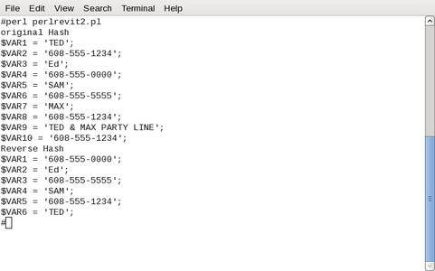

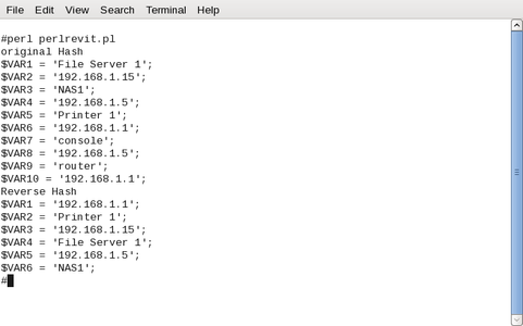

Now let's see what we can do with approach number 2.
# original hash from approach 2
$VAR1 = {
        'city2' => {<br>                    'zip3' => 1,
                    'zip1' => 2
# Extending from approach 2 above
# Reverse it
my $revhash = {};
foreach my $key (keys(%$hashref)){
foreach my $val (keys(%{$hashref->{$key}})){
  $revhash->{$val}->{$key} = $hashref->{$key}->{$val};
print Dumper $revhash;
Output:
#perl revit.pl
$VAR1 = {
          'zip3' => {
                      'city2' => 1
          'zip1' => {
                      'city2' => 2
Notice how the keys and values have swapped, and that the link count remains the same.
