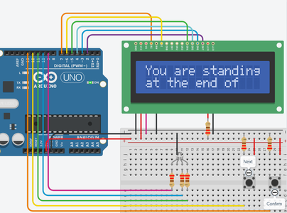

Today I will be showing you how to make a text based game
  • Arduino Uno
  • A LCD screen¹ connected to pins 7, 6, 5, 4, 3, 2 (RS, E, DB4, DB5, DB6, DB7 respectively)
  • Two push buttons connected to pins 12 and 13
  • Five 220 ohm resistors
  • An RGB LED connected to pins 9, 10, 11
