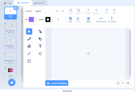

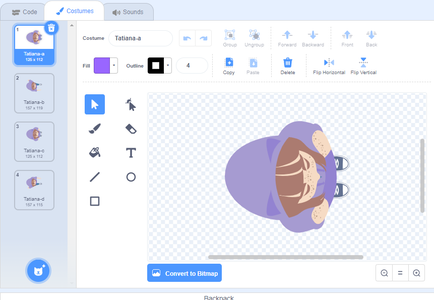

Step 1: Put the Costumes in the Right Order
So, here is Tatiana's costume that you can take directly in sprite ,you don't need to reorder the costumes, and for the costume that will serve as our background, you can put it in the order as in the image, the order of which you are going to put them will change the code you will need to code.
For the other sprites, you don't need to put them in order because there is only one costume for the other sprites.
The names of the costumes could also change your codes.

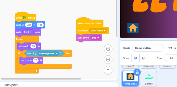

We will now take care of the Home button.
We're going to put it in its place and put it in the foreground so that the other sprites don't hide it.
We are also going to add a size effect so that it grows a little when the mouse is over the sprite, we are also going to add this effect to the sprites that allow you to choose the level.
We'll also send a message that will toggle to the menu costume, in the sprite we're using as our background, if that sprite is clicked.

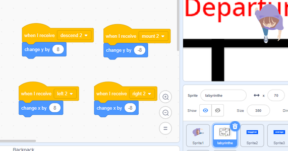

Now, we are going to code the movement, as it is the maze that we are going to move, we are going to put the opposite of the numbers that we would have put if it was the character that we would have moved. This will give the impression that the character is moving.
So that we don't cross the walls, we are going to send a message each time we move to check that we are not crossing the walls, and if the character touches the wall, it sends another message to say that we have to step back.
The extra steps you take to back up allow you to put a tremor effect to attract the player's attention, so that he realizes that he is bumping into the wall.

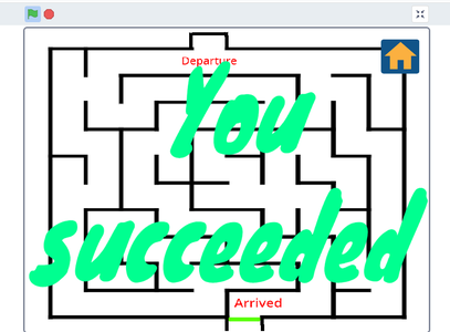

As the goal of the game is to arrive at the finish line and as there, for the finish line, I marked it with a green line, so we are going to make the character repeat indefinitely: if she touches the line green, it sends a message to say that we have succeeded.

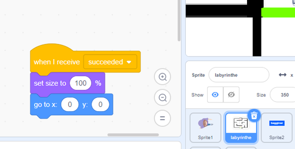

When we receive the message, for the labyrinth, we will have it set to 100% of its size, ie its normal size, for aesthetics.
Then, we will display the text ''You succeeded'', we will adjust its positioning and its size, we will play the win sound and we will add a size effect.

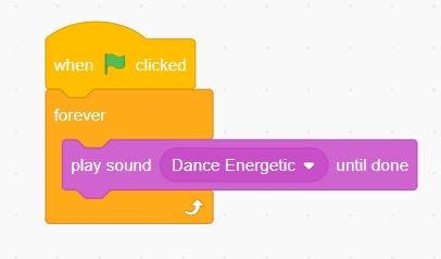

Finally, we are going to repeat music that is already on scratch and that we are going to play for the duration of the game.
