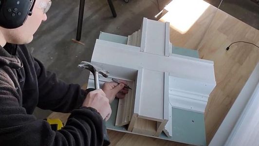

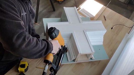

Step 4: Install Vertical Trim Pieces
For my verticals I used 1x6 primed pine boards. Cut and install all of them in one direction, then cut and install perpendicular pieces. These pieces all need to fit nice and snug. They should be brad nailed to the frame pieces and brad nailed to each other on the ends. You can also glue them at the ends in addition to nailing.

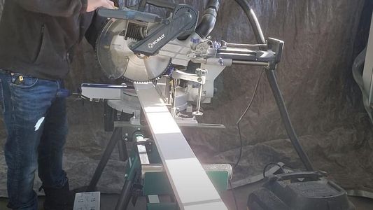

Step 5: Cut and Install the Bottom Pieces
Cut and install all of the bottom pieces in one direction. I like to install mine 1/4" recessed for a shadow line, but this is just personal preference. My bottom pieces where 1x4 primed pine. Ideally, the first direction should span the entire room. Then cut and install the shorter perpendicular pieces. These pieces should fit snug and be flush with the other bottom pieces and should be installed using brad nails.
Step 6: Install Crown Moulding
Carefully cut and install crown molding using brad nails.

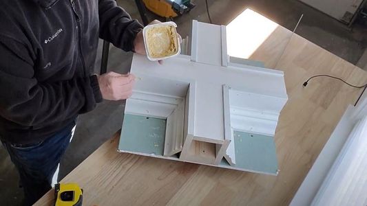

Step 7: Finish
Sink all brad nails and fill holes. Then sand everything smooth and wipe down with a damp towel. Finally, caulk all joints and paint.
