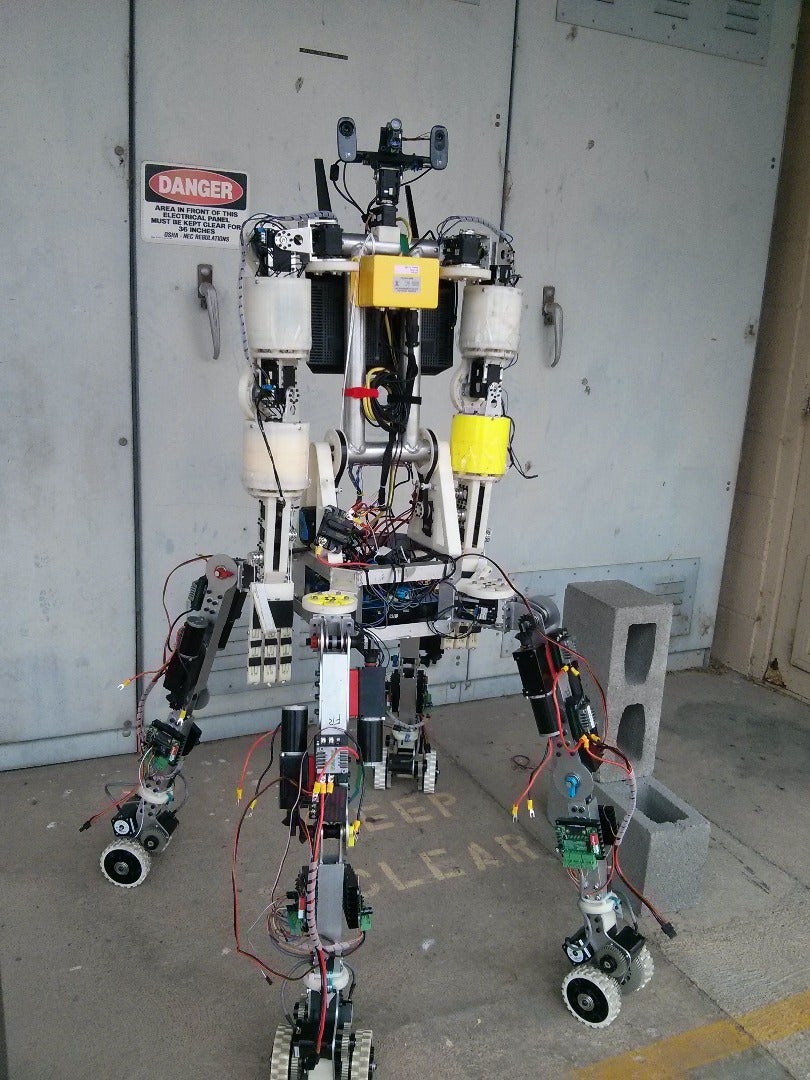

The legs we used at the Finals were designed about 3 weeks before the Finals. Our mechanical engineer is also a #FRC First Robotics mentor. So we went with what he knew. What we built was a motor, 3 10:1 planetary gears (for 1000:1 ratio), Talon motor controller, same SpectraSymbol Softpot, and again a Arduino Pro mini. Mechanical, Electronics, Software End-to-End in 3 weeks, not a bad pace for voluteers and enthusiasts. In the end all the components for this "servo" cost $200.00, and can be repaired with $30.00-$50.00 replacement parts.
We did replace a Hex-Shaft output during the Finals at a cost of $30.00. A completely different story than a $500.00 repair for a similar failure on the old servo mechanism.

The picture shows the different pieces of the "servo" joint.
  • A) SpectraSymbol Softpot with McMaster-Carr grub nut pressure pin and 3D Printed mount. The sensor shown is for the knee joint while the motor, gearbox, and bevel gears are for the femur joint. But the sensor for femur is identical.
  • B) The Vex BAG motor
  • C) 3 Vex 10:1 planetary gears, with motor interface and hex output shaft blocks.
  • D) Two Vex bevel gears
  • E) Talon Motor Controller
  • F) Arduino Pro Mini
  • Various nuts, bolts, wires, and hex shaft and bearings
  • On 1-1/4 square aluminum extrusion
  • Custom Laser cut aluminum plate
