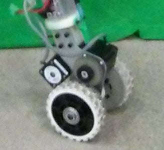

This is one of the most experimental pieces we put on Cog-Burn our #DARPADRC Finals Robot. The concept is that the foot freely rotates at the top of the foot, the ankle for lack of a better word. This is a simple "lazy susan" like bearing between the tibia and the foot. We then sense the rotation of that bearing to drive wheels on the ground. This implementation specifically uses stepper motors and a softpot, but the idea could be extended in many ways and use different components. An encoder and DC brushless motors could have been used just as well.
The SpectraSymbol Soft Pot that measures the rotation of that "lazy susan" bearing, and we use the recommended pressure pin for that potentiometer.
There are two 115 oz-in stepper motors that are run as a "tank" steering pair of wheels on the foot.
The robot can drive any direction you want by running the two motors differentially until it points in the correct direction, then when the tires are pointing the correct direction drive them at the same speed to move the robot, or other object in the desired direction.
What we like best about this design is the parts are identical, for the swerve steer. In normal swerve steering you have a different mechanism for turning the wheel than the one to drive the tire.

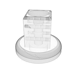

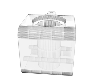

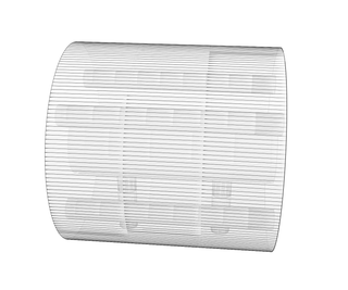

Step 4: Custom Mechanical Parts: 3D Printing and
We have 4 mechanical parts for the foot.
  1. Knee Lower Leg Pivot Upper 3D Printed
  2. Knee Lower Pivot Lower are 3D Printed and used to make the "lazy susan" bearing interface.
  3. Ankle Bearing Block is 3D printed, and is the separator for the metal side plates.
  4. A DXF for cutting the metal side plates.
All this is bolted together with SAE size bolts except the 8 bolts that hold on the NEMA 17 motor.
