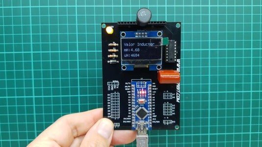

In this tutorial we will see how to create an inductor meter with an Arduino Nano, an OLED display and other electronic components.
Step 1:
More info and updates in https://rogerbit.com/wprb/2022/06/medidor-inductores/
In this tutorial we will see how to create an inductor meter with an Arduino Nano, an OLED display and other electronic components. We will build the circuit which includes the printed circuit, we will analyze the source code, and finally we will test its operation, coils or inductors from Wurth Electronics.
In this circuit whose main component is an Arduino nano, to control the OLED display, measure and calculate the value of a coil or inductor, whose value is unknown, this is an economical meter with quite good precision, as we could see in the video shown above.
The coil or inductor is a passive component made of an insulated wire that, due to its shape (coiled wire coils), stores energy in the form of a magnetic field, by a phenomenon called self-induction. The inductor is different from the capacitor, which stores energy in the form of an electric field.
Many times when disassembling a board, to extract its components, or repair them, we find inductors that do not have a reference on the component's silkscreen that allows us to identify it, this is why this device can become a great ally when repairing or extracting this type of electronic components.
Inductors or coils are measured in a unit called Henri, whose symbol is represented by the letter H. For our meter we will show on the display two sub-multiples of this unit with the mH (milli Henri) and the uH (micro Henri).
The device is based on the measurement of an LC (Inductor/Capacitor) oscillator circuit. These two components are connected in parallel, and a voltage pulse is applied to this LC circuit for a certain time. It will begin to oscillate at a frequency determined by the value of these two components, this is known as resonance frequency.
We are going to apply a 5 volt voltage pulse to the LC circuit. We charge the LC circuit for a while and then return to 0 volts. The pulse will cause the circuit to resonate creating a sinusoidal signal, which will attenuate over time, due to the internal resistance of the circuit itself, it will oscillate at the resonance frequency depending on the values ​​of the inductor and capacitor. We are going to use the arduino to obtain the frequency and with the following formula applied in the arduino source code, it will allow us to know the value of the inductor whose value is unknown.
This meter has a range of approximately 80 uH to 3oooo uH

Step 2: Source Code
#include "U8glib.h"//Librería para el control del display oled
U8GLIB_SH1106_128X64 u8g(U8G_I2C_OPT_NONE);// I2C / TWI // Se habilita esta linea según el display a usar en este caso el driver SH1106
double IPulso, frequency, capacitor, valormH, valoruH, inductance;
int muestras = 250;
const int pulsoEntrada = 11;
const int pulsoSalida = 12;
void setup()
Serial.begin(9600);
pinMode(pulsoEntrada, INPUT);// Lectura del pulso de entrada
pinMode(pulsoSalida, OUTPUT);// Carga de la circuito resonante LC
delay(2000);
void loop()
valoruH = lectura();
valormH = valoruH / 1000;
//Muestra el valor en mH en el terminal serial
Serial.print("Valor: ");
Serial.print(valormH);
Serial.println(" mH");
//Muestra el valor en uH en el terminal serial
Serial.print(valoruH);
Serial.println(" uH");
delay(1);
//Display
u8g.firstPage();
do {
draw();//Llama a la función draw
} while( u8g.nextPage() );
//Funcion
double lectura()
double sumaInductancia = 0;
for (int contador = 0; contador < muestras ; contador++)
digitalWrite(pulsoSalida, HIGH);
delay(5);// Tiempo para cargar la bobina.
digitalWrite(pulsoSalida, LOW);
delayMicroseconds(100);// verificar que mide la resonancia.
IPulso = pulseIn(pulsoEntrada, HIGH, 5000);//Transcurrido este tiempo pulsein devuelve un varlor 0
if (IPulso > 0.1)
capacitor = 2.12E-6;// Medir la capacidad del capacitor para mayor presición y cambiar ese valor obtenido
frequency = 1.E6 / (2 * IPulso);
inductance = 1. / (capacitor * frequency * frequency * 4.*3.14159 * 3.14159);
inductance = inductance*1E6;
sumaInductancia += inductance;
return (sumaInductancia / muestras);
//Función para mostrar los datos en el display
void draw(void) {
//Imprimimos en pantalla el valor de la inductancia en henrios obtenida en unidad en mH y uH
u8g.setFont(u8g_font_unifont);
u8g.setPrintPos(0, 20);
u8g.print("Valor Inductor");//
//Muestra el valor mH
u8g.setPrintPos(0, 40);
u8g.print("mH: ");//
u8g.setPrintPos(25, 40);
u8g.print(valormH);
//Muestra el valor uH
u8g.setPrintPos(0, 60);
u8g.print("uH: ");
u8g.setPrintPos(25, 60);
u8g.print(valoruH, 0);
