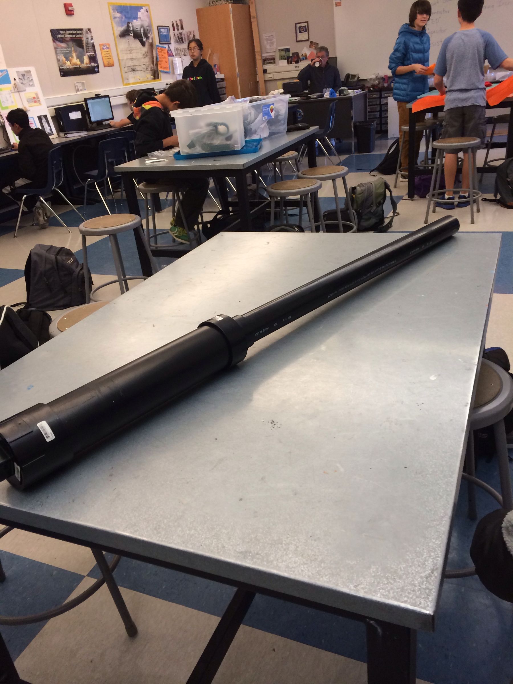

Barrel Portion
- a 3/4 inch non magnetic tube
- a 22 gauge lightly insulated copper wire
- any flat surface, I used 80x20
Projectile
- 1/8 or 3/16 in ball bearings
For spacing of the ball bearing vs the wire for shooting, I found the best place to put the ball bearing is right behind where you started wrapping the wire.

Step 4: Starting
Take your insulated wire, and wrap it around the tube starting from the front, and working your way to the back, and then keep rewrapping until you get to the front again.
MAKE SURE THE LEADS OF THE WIRES ARE FACING BOTH DIRECTIONS.
Leave about an inch off the wires, and strip the wires down to the copper.
