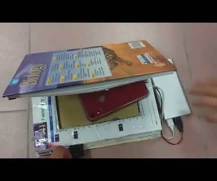

This part will be all about software. First, the code will make the servo motor to work, by reading in the gravitational force that an object acts on the force-sensitive resistor(a.k.a. Pressure sensor), and rotating servo motor according to the value of the force. But remember, If you are using Arduino Leonardo, never use pin D13. It will cause the value of the servo motor weird. So I change the code from "Simple - Kaonashi Coin Box by ChunKyuP" and changes to pin D11. Also, I added a red light to let the coin box looks more colorful. The light was important to let the get user get more in it.
please made the pinD13 to D11, also add the led with the picture 2
the link of code: https://create.arduino.cc/editor/jacob_1122/50a65c06-4cc0-4941-9aec-790d59b593da/preview
Step 3: Step 3: Finish - Put All the Parts Together
This is where the project is getting finished. You can test out if the coin box is working by putting some coins. If it does not work, put little heavier objects, Or If you want, you might change the value if you need it. this could help your project work better.
