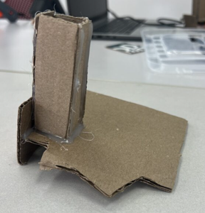

Cut out four pieces of cardboard that are 3 inches tall and coin diameter wide (the general idea is to create a box where only one coin can sit on the bottom at a time), see pictures one and two. Then hot glue them together to form a rectangular prism as shown in pictures three and four. Repeat this process three more times so that you have four complete boxes when finished.
Step 2: Building (Coin Dispenser Mechanism)
Using your cardboard, cut out four rectangles that are 2.5 inches tall by 1 inch wide (see picture one), these will be piece one. Next, cut out a shape like the one in picture two that is 4 inches wide at the bottom and 5 inches tall at the tallest point (keep the shorter sides about 4.5 inches tall). This will be piece two; repeat the previous step to make four of these total. Using picture four as a reference, hot glue the side of piece two to the middle of piece one. Once that has dried hot glue the coin holder (picture three) from the previous step to the side of piece one and bottom of piece two. Tip: Feel free to label the pieces physically to make assembly easier!
Step 3: Building (Coin Dispenser Mechanism Part 2)
Next cut out a section of the cardboard in piece two from the previous step. Next cut out a piece of cardboard about 1 inch tall and 0.5 inches wide and attach it to piece two (next to piece one as seen in the images above) using hot glue. Next create a square about 2 by 2 inches using a thinner material than cardboard (we used the carboard from soda boxes). You will then hot glue your servo motor to this 2x2 piece so that when the servo motor spins the cardboard can knock the coins out of the slot. Beneath this piece will be another piece of cardboard that has a cutout for the servo motor, you will then hot glue the servo motor into this cutout as seen in the third image. Essentially you are creating a sandwich of cardboard in which the coins and servo motor sit so that when the servo motor moves it slides the coins out of the slot so they drop down into the container you will build later. Repeat this process for all four Coin Dispenser mechanisms. We included several photos above and we recommend looking at them as a reference. (There are also additional photos included that show the servo motor glued to the cardboard piece before the entire mechanism is put together. You may find these helpful to look at by clicking on see more images).

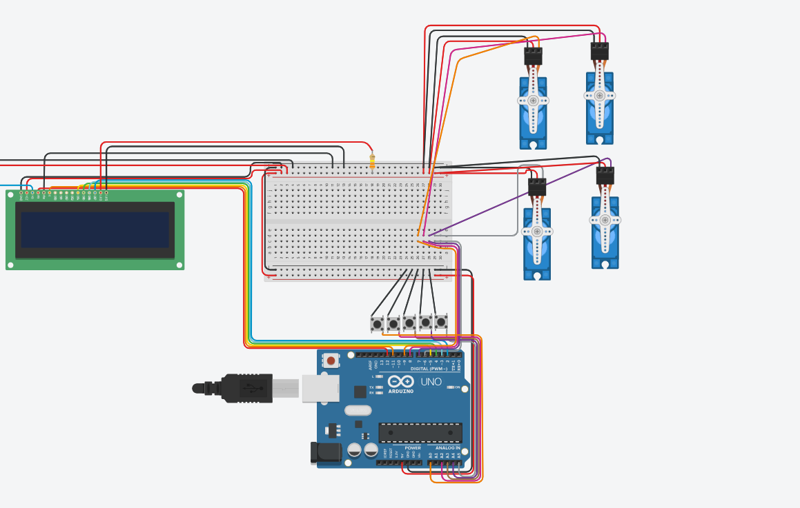

Step 11: TinkerCad Wiring
Creating this project in TinkerCad first may help you make sure you have properly wired and set up your arduino and breadboard before recreating it using your sparkfun kit.
Link to an explanation of the wiring in the TinkerCad image above:
