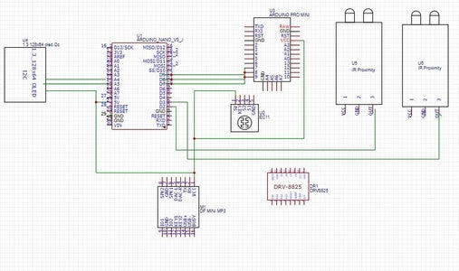

Step 6: Circuit Diagram & Soldering
I have provided a rough sketch/schematic of the design more details about the pin numbers can be found from the code.
Solder it onto a perf board with the help of male and female connectors to make it easier and wire free and neat
