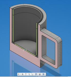

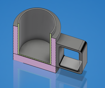

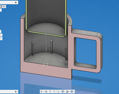

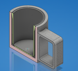

The warm cup has to be big enough to hold with two hand, so we measure our diameter with two hands making a circle. This made sure the cup is a good size for holding. We made a model in fusion 360 by using that dimension. Then we made the inner cups, and we realized that the cup wouldn't just fit in through friction(image 1). The solution is to make some locating tabs to support the inner cup to guide to the right place, and this also reduce the heat conduction between the cups(image 2). This creates another problem that there is a gab between two cups(image 3), so we made the top of the inner cup thicker to fill in the gap(image 4).
