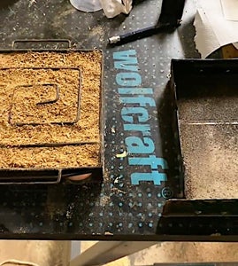

square Cold Smoke Generator,

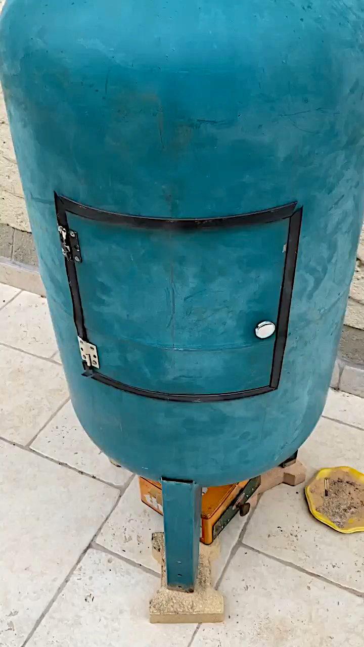

Step 1: The Top Part - the Door Hole
Measure and mark out the door.
Cut out the door.
Clean the surfaces. It should be free of any contaminants.
Step 2: The Top Part - the Door
Drill holes for the hinges and attach the door.
So that the cut-out door does not fall inward, to protect the edges of the metal sheets and to close the gaps, add sheet metal edge protector.
Step 3: The Bottom Part - Drawer for the Cold Smoke Generator
Make a box for Cold Smoke Generator out of one biscuit metal box. This box with the Generator will then be inserted as a drawer into the bottom part of the cold smoker. Cut the biscuit box, fold and with pop rivets to hold.
To make it easier to pull out the drawer, screw the handle to it.

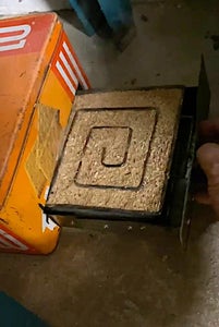

Step 4: The Bottom Part
Cut a hole in the second biscuit metal box for the drawer with Generator made in the previous step (see photo). It is not really hermetic (there is a hole for the slide) and it allows air to get in because there is a need for air intake for the smoke.

Step 6: Final Details
Drill a hole in the door of the top part for a handle. Screw on the handle.

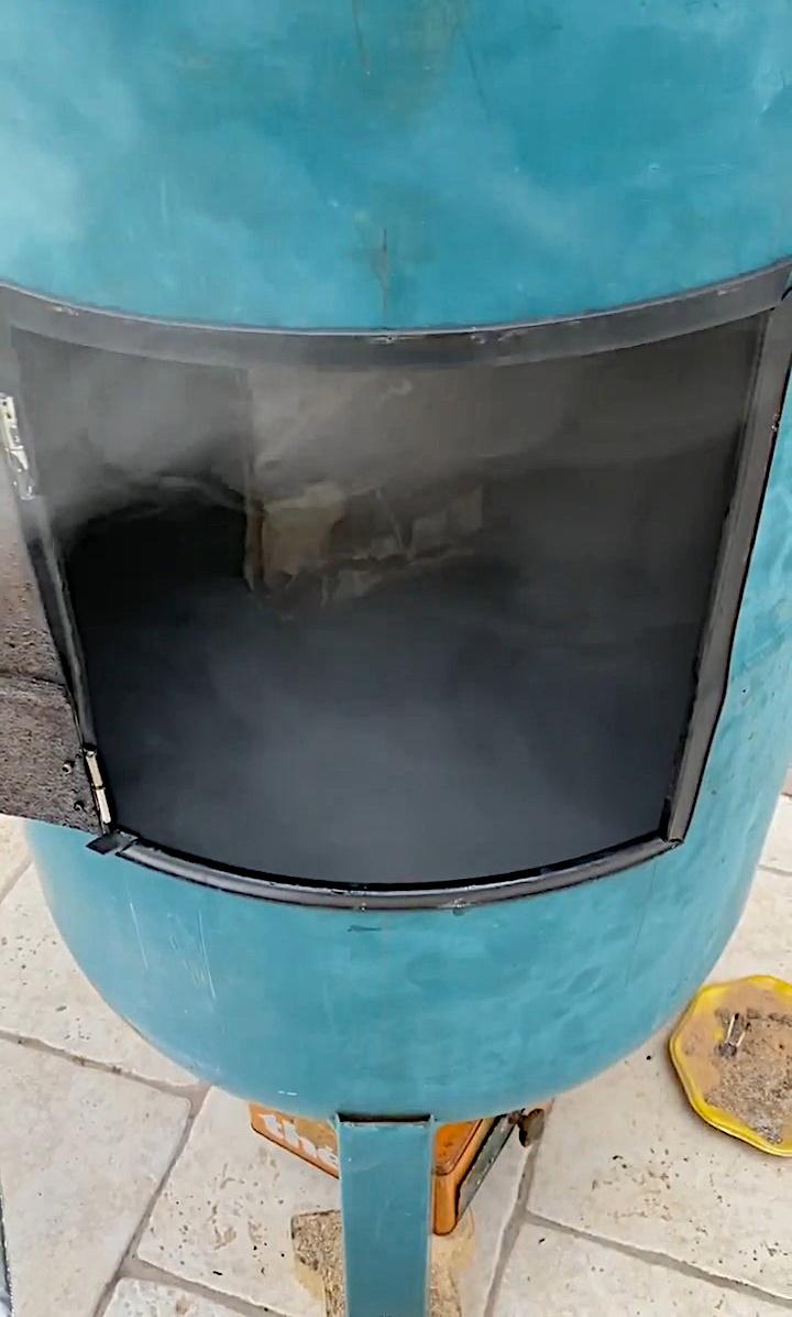

Step 7: Use It
Prepare food for smoking.
For preparing the meat: 18 hours in salt for 1 cm of thickness, then in fresh water 1 hour skin up to remove most of the salt, then dry some time 1 h over with fabric.
To start the smoker, it’s better to use a small candle, as it’s not immediate. And wood dust must be dry. Light the tea light / dish heater candle, place it under the start of the spiral of the Cold Smoke Generator, wait utill it starts smoking, then you can remove the candle and blow it off.
Insert the Cold Smoke Generator into its drawer.
Slide the drawer into the bottom part of the smoker.
Wait until done. Periodically check whether the wood dust has finished smoking, the readiness of the food.
