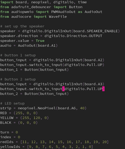

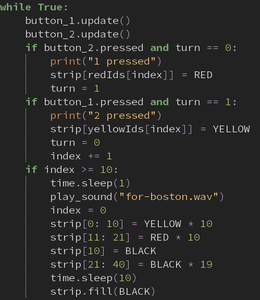

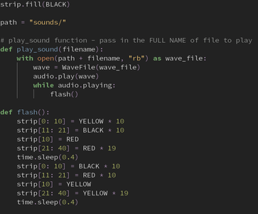

This code is fairly simple, using a CPB to control the LED strand. I used two arrays with the locations of the lights that should turn on for both the red and yellow sides, to make quick changes to code once the LEDs were attached. I created a function to animate the lights once the game is finished and have it run when sound is playing. The code uses two debounced buttons to check if the switches have been pressed and uses a variable named 'turn' to check if the right player has hit the button.
