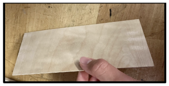

  • 1.5mm sheet of wood

Now go back to your model and see what things you still need to add using wood or other physical materials. In my case, I'm going to add my desk, Tabletop, and chair using the 1.5mm Wood I described in the supplies. I'll stuff the chair and desk support and create couches using styrofoam and cork. You can add a covering on the top, such as felt or leather if you feel the need to.
