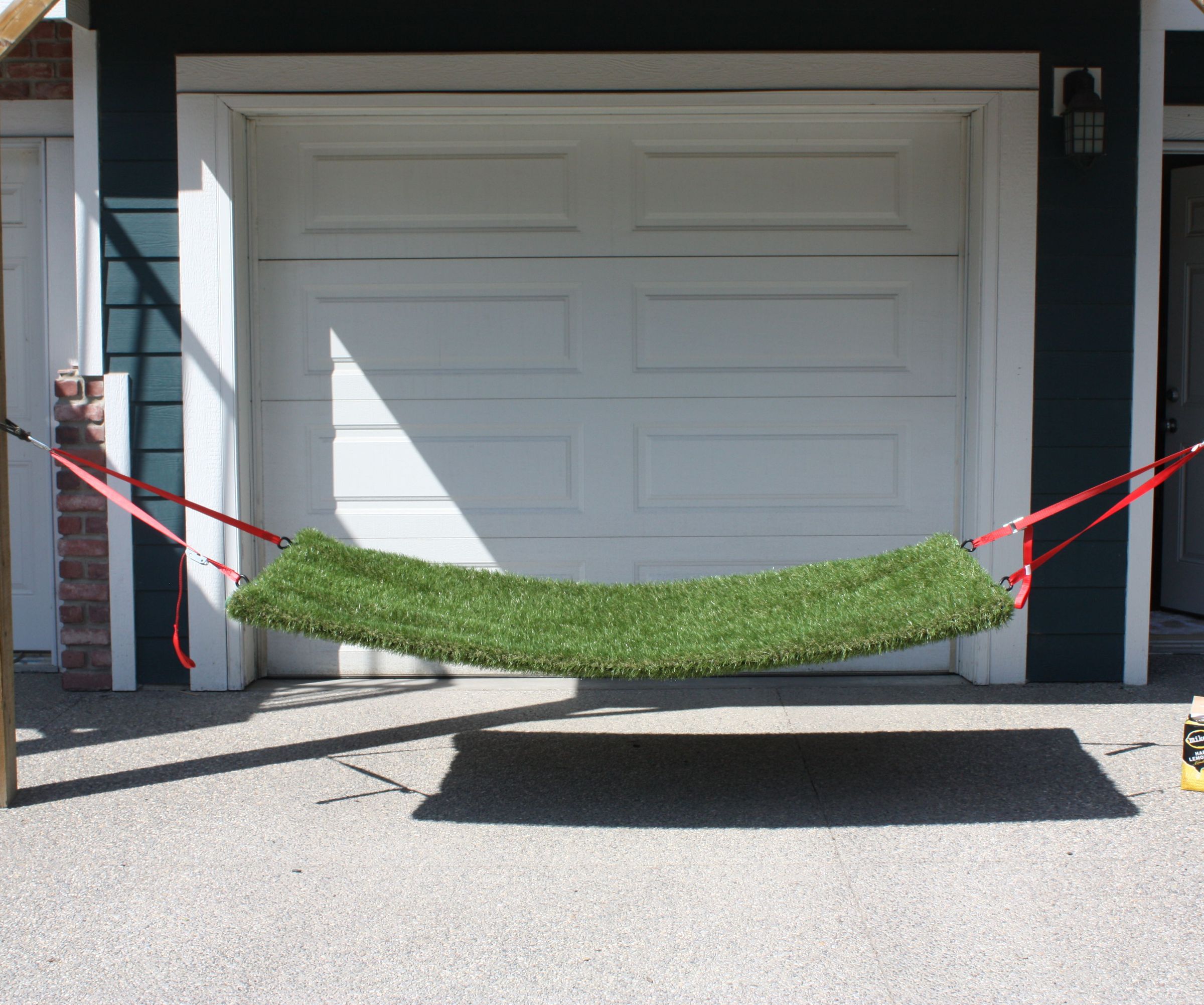

I started by attaching the 2 4 Ft. lengths together with the 10" Hinge and 5/16" lag bolts .
Then placed 2 of the 4 ft 2X4's next to the hinge and moved it away from the hinge to allow it to rotate later. I then drilled into the center of the 2X4 and then into the 4X4 and then attached them with carriage bolts, round side down. You might have to hammer the bolt in it's a tight fit.
I then flipped it over and then rotated the 2x4 to make a base.
I then attached the other 4x4's to the end of the base with the remaining 2 hinges and 1/4" lag bolts.
Once I had the 4X4's attached I used the Hasp hinges on the end to hold them in place. This step is optional but makes setup much easier in my opinion.
I then clamped the remaining 4 2X4's together and drilled through them with the 1/2' auger bit and then the 5/8 spade bit later. I made the hole bigger to make setup easier later. I put holes on each size of the board. I then attached the 2X4's to the upright and base 4X4's temporarily with clamps when they were in a position I thought was strong enough and also low enough to not hit the bottom of the hammock. I then drilled through the 4X4's with the auger and then the spade bit again. You should try to drill as straight as possible but there is lots of flexibility in the hinges and using the bigger holes.
Once you finished drilling all the holes in your 4X4's put the remaining carriage bolts through the holes. Then attach with the washer and nut. Finger tightness is good enough.
Step 2: Finishing Up
I cut some reliefs into the backs of the upright 4X4's. This gives the hammock somewhere to put the straps from the hammock. I cut them with the Skil saw with one straight cut and one at 45 degrees. I also cut a relief into the poles so that when folded it fits tighter over the bolts sticking out from the bottom base. I could have cut back the bolts but this helps keep it folded nice and tight.
Step 3: Setting It Up
Start by unfolding to the flat position.
Extend the stabilizing legs.
Extend poles and secure with hasp hinges(if installed).
Attach support braces with the carriage bolts and secure with nuts and washers.
Attach hammock and relax with a refreshing beverage!
