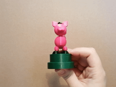

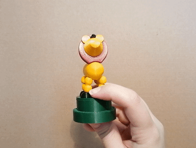

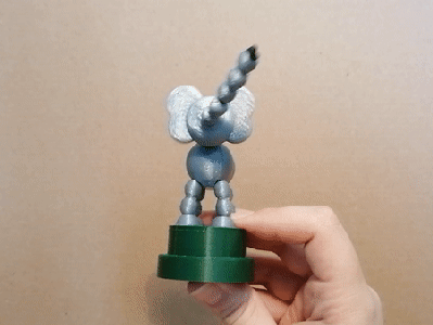

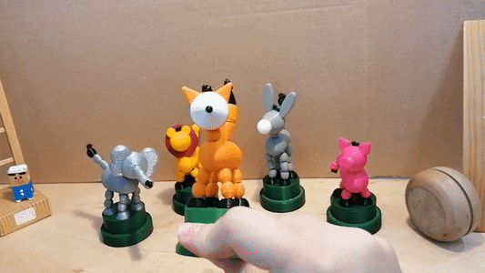

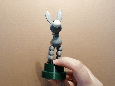

We've designed these collapsible animal toys for 3D printing based on toys from our childhood that were made from wood. When you press the button that is spring-loaded, the strings that hold all the parts together get loosened and that makes the animal collapse. This model was made by Adrien from our 3Demon team.

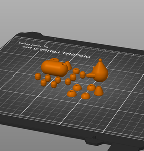

- The legs and the tail are composed by the files standard_pearl and standard_foot (except the fox and pig tails composed by specific pearls). So print the standard_pearl and the standard_foot as many times necessary.
- Print the pearls vertically - Print the right standard_support and standard_button that fit with your spring ( e.g. for a 10mm diameter spring, print the standard_supportd10 )
- The head should be printed with its ears horizontally and muzzle on top.
- Manually remove in your slicer the supports inside the holes. They are not necessary and you will have more work with the print if you would let them generate.
Print Settings
- 0.2m layer height
- 45° supports
- 15% infill
- Brim: 4mm

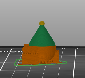

Step 3: Color Change in the Slicer
If you want some pieces to change color at some point in the print, here's how:
PrusaSlicer: If you are doing the slicing in Prusa, it's pretty simple. Slide down to the layer you want your colour to change click on the plus sign like it's shown in the second image. If you want it to change somewhere else just repeat the same process and after slicing it you should have parts with different colors.
Other:
1) On your slicer, find the layer where the color has to be changed.
2) On the file .gcode (open with Notepad), before the line corresponding to the layer, put a new line with the command M600.
3) Your printer will pause printing when you set to change the filament.

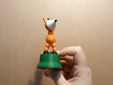

Start by making knots as close to the head and tail as possible. However, since the toy is in its collapsed phase if you make it a little bit further from the head and tail it should be fine.
Remove the bar that is pressing the button down and try how the animal collapses. If you like the way it moves, cut the thread above the knots. If it's too tight or too loose, put the bar back in place and try again.
Step 10: There You Go, You Have Your Animal Assembled!
I hope you enjoyed this project. You can have a look at some of our other models on our website
