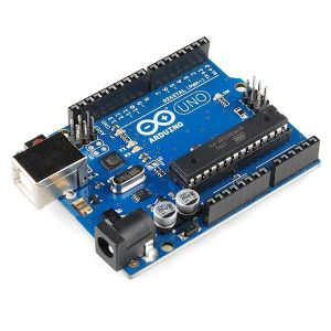

1.Controllers : Arduino UNO

Step 2: Step 2 : Circuit Design and Connections
Now it's time to connect all the components to Arduino through wires!
Ultrasonic sensor(HCSR04) to Arduino Uno
  • VCC pin of Ultrasonic sensor is connected to 5V power supply of Arduino.
  • GND pin of Ultrasonic sensor is connected to GND pin of Arduino.
  • TRIG pin of Ultrasonic sensor is connected to 7th pin of Arduino.
  • ECHO pin of Ultrasonic sensor is connected to 4th pin of Arduino.
