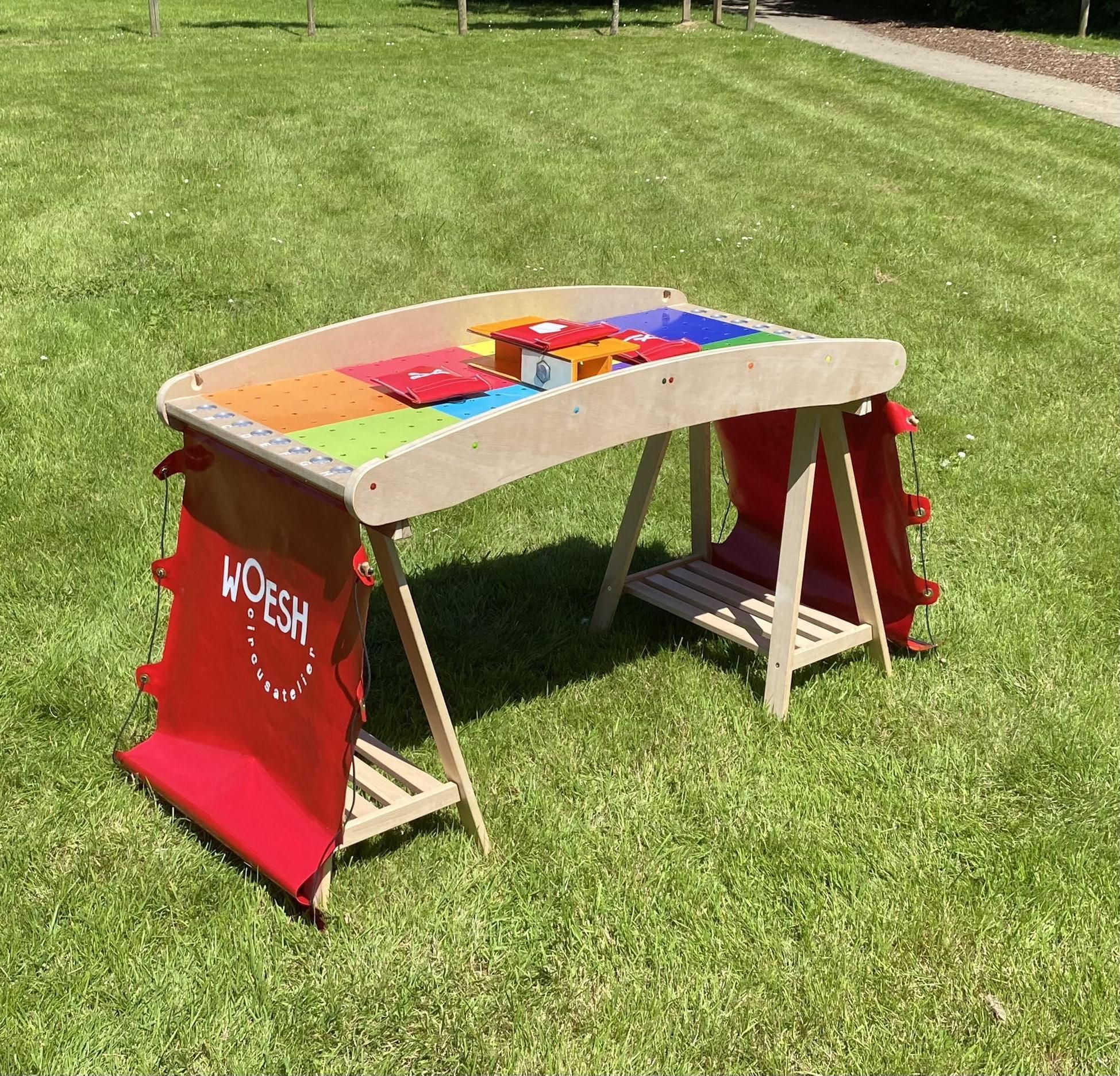

Introduction: Color Bounce - Remake (CNC)
Meet the Color Bounce - an ingenious tool revolutionizing juggling for individuals with motor limitations. This modular board, equipped with a color grid, pins, rubber bands, and ramps, fosters rhythm and coordination. Its adaptability, from single-person setups to multi-person challenges, caters to all skill levels. With features like adjustable borders and different levels, the Color Bounce ensures an inclusive and enjoyable juggling experience for everyone. Welcome to a new era of accessible and engaging juggling learning.

Step 1: Crafting the Main Board
Materials & Tools needed: MDF Board (18mm), Plywood plank (3.6mm), CNC Machine, 3D printer
Start the 3D printer:
  • Start the printer using the .stl files in the attachement (16x the bottom one and 2 times the upper hexagon part).
Lasercutter:
  • Laser out the provided icons that later will be used to mark the pouches and letters/numbers on the board.
Design the Grid Pattern:
  • Utilize a 3D modeling software to create the desired grid pattern for the Flipperboard. This design will guide the CNC machine during the cutting process (look at the attachement).
Prepare the MDF Board:
  • Secure the 18mm MDF board to the CNC machine bed, ensuring it is tightly fixed and ready for precision cutting.
CNC Cutting:
  • Initiate the CNC machine to cut the MDF board according to the designed grid pattern. This process will create the holes and cut-outs needed for the Flipperboard's customizable setup.
Glue:
  • Use the wood glue to secure the bottom plywood plank to the main board.
3D prints:
  • If the glue has dried, put the bottom parts of the 3D prints inside the Ø35 mm holes and make sure it fits right up to the surface.
Stickers:
  • As final step of the main board, stick the stickers on the same place as the templates and make sure everything fits together nicely without any gaps. Finally, poke out all the holes of the main board so the pins can slide in.
  • Stick the letters and numbers each to one side from A-H and 1-8 underneath the aiming system.

Step 7: Final Assembly
Materials & Tools needed: Wood glue, MITTBACK Ikea trestles, All parts.
Assembly:
  • Take the main board and glue both sides onto it. Tighten the assembly using clamps and other objects to hold it in place. Once the glue has dried, place the piece on two trestles. Attach the covers in the predesigned gaps, fill the pouches with the dowels, elastic cords, and playing cards, then put the ramps and balls in place. Finally, close the entire box.
  • Make a handle with some leftovers of the tarpaulin and secure it to the bottom of the box to carry it around.
Closing and Transportation:
  • Stretch the tarpaulin tightly over the box. Nail the hooks to the bottom of the box, placing each one between two grommets so the elastic cord can easily be hooked over them. Add a handle or carrying strap to the box for easy transportation.
