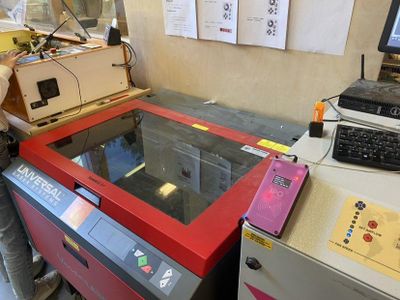

Step 1: Lasercutting and 3D-Printing
Materials & Tools needed: Extra wood (6x 400 mm x 600 mm x 5 mm), Lasercutter, ABS, 3D printer
Make the templates:
  • Place the plank in the lasercutter and cut all the templates out (see attachement). These will help while milling the walls and holes by hand.
Lasercutting:
  • Laser out all the parts for the ramps (see attachement) and the icons.
3D printing:
  • Print the .stl file (see attachement) of the ramps aiming system out of ABS (16x the round bottom and 2x the hexagon).

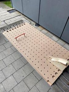

Design the Grid Pattern:
  • Utilize a 3D modeling software to create the desired grid pattern for the Flipperboard. This design will help visualize and measure the necessary cutouts (see attachement).

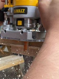

Prepare the MDF Board:
  • Secure the 18mm MDF board with the clamps. Use the templates (see attachement) to locate the holes on the board with a sharp object.
Sawing and drilling:
  • Use the Palm router to cut out all the holes provided by the templates. Thereafter, drill 8x Ø35 mm hole on both sides, in the middle of the board (see attachement).
Band saw:
  • Saw out the 4 corners of the board and the plywood plank as shown in the attachment (12x60mm x4).

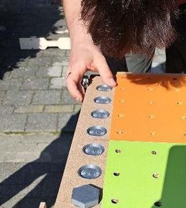

Glue:
  • Use the wood glue to secure the bottom plywood plank to the main board.
3D prints:
  • If the glue has dried, put the bottom parts of the 3D prints inside the Ø35 mm holes and make sure it fits right up to the surface.
Stickers:
  • As final step of the main board, stick the stickers on the same place as the templates and make sure everything fits together nicely without any gaps. Finally, poke out all the holes of the main board so the pins can slide in.
  • Stick (or spray) the letters and numbers each to one side from A-H and 1-8 underneath the aiming system.

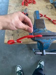

Materials & Tools needed: Elastic cords (Ø7 mm), (steel) wire, heat shrink, hand tools
Cutting to Size:
  • Cut the elastic cords into 6 pieces, each approximately 450 mm in length. Burn the edges to prevent fraying.

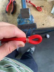

Make Closing Loops:
  • Wrap wire around both ends of each elastic cord to create loops that fit over the wooden dowels. Ensure the wire is wrapped tightly so the loops stay securely in place.
Apply heat shrink:
  • To make it safer to use, apply heat shrink on the wire.
TIP: Use a vise to secure the wire, allowing you to tighten it more effectively.

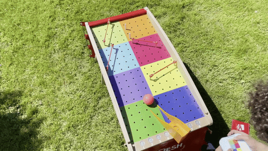

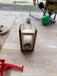

Step 7: Assemble the Ramps
Materials & Tools needed: Laser cut ramp pieces, nail gun, 3D print (top parts).
Assembly:
  • Position both sides next to each other and place the plate with the hexagon hole at the bottom. Secure these plates together using a nail gun. To ensure stability, place the other plate halfway onto the ramp, ensuring the ball can still pass without touching the piece. Secure this plate with the nail gun as well.
EXTRA: Spray the ramps in a bright color to give it a nice touch.

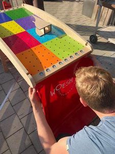

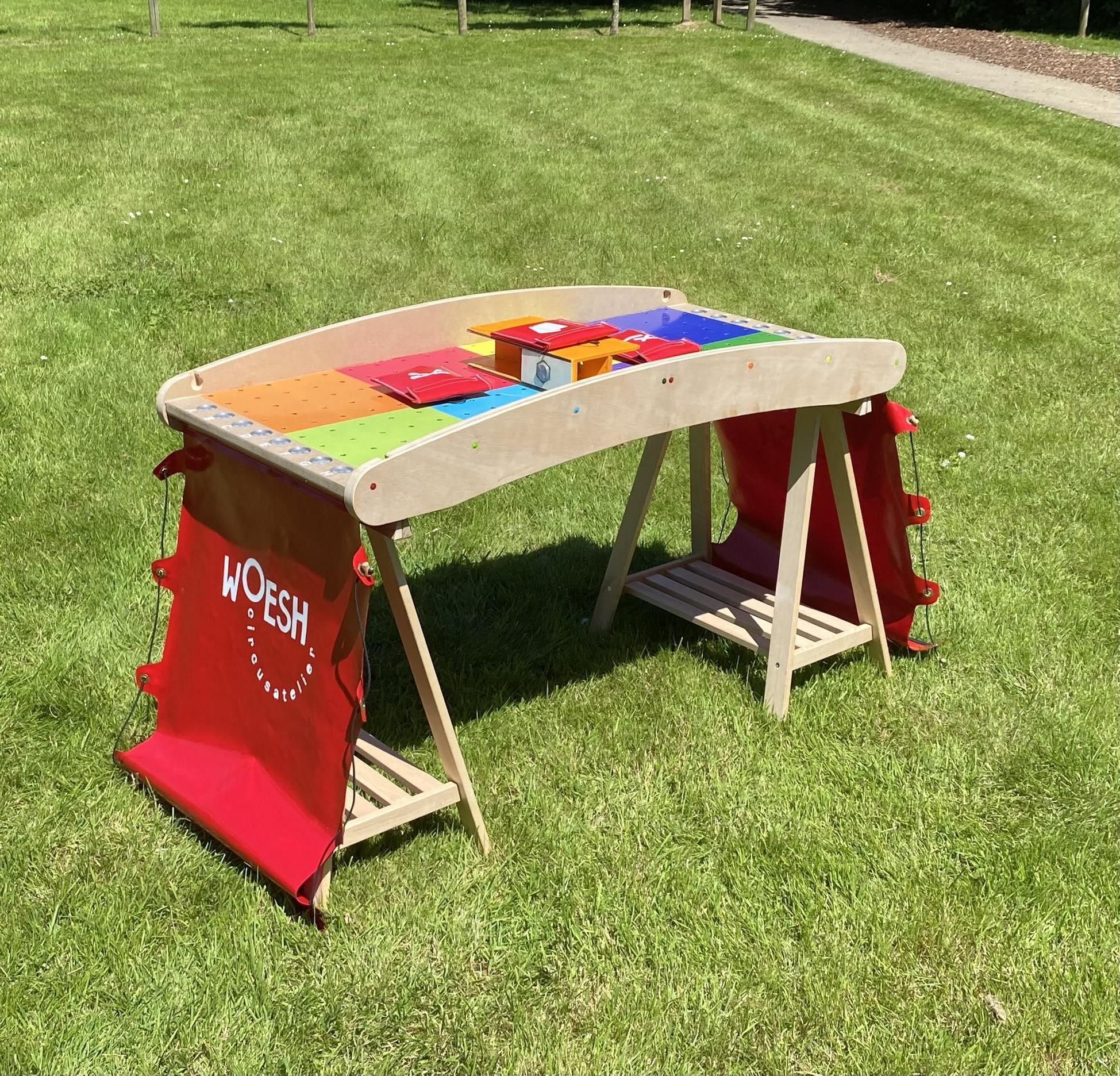

Materials & Tools needed: Wood glue, MITTBACK Ikea trestles, velcro circles, All parts.
Assembly:
  • Take the main board and glue both sides onto it. Tighten the assembly using clamps and other objects to hold it in place. Once the glue has dried, place the piece on two trestles. Attach the covers in the predesigned gaps, fill the pouches with the dowels, elastic cords, and playing cards, then put the ramps and balls in place. Finally, close the entire box.
  • Make a handle with some leftovers of the tarpaulin and secure it to the bottom of the box to carry it around.
Closing and Transportation:
  • Stretch the tarpaulin tightly over the box. Nail the hooks to the bottom of the box, placing each one between two grommets so the elastic cord can easily be hooked over them. Add a handle or carrying strap to the box for easy transportation.
