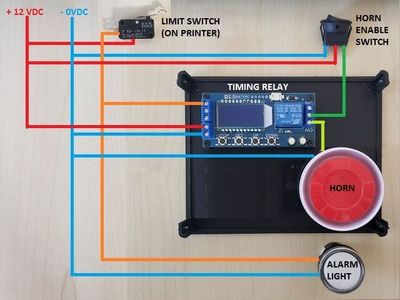

Step 1: The Circuit
The power supply on my printer is 12VDC. So, I chose parts that were compatible with that.
The Limit Switch was positioned next to my Y-axis home limit switch so that it comes on at the same time without interfering with the other limit switch. When in the home position, the switch is wired to the Timing Relay's trigger input for sounding the horn. It also powers the LED Light directly. I have considered using the Normally Closed contact on the limit switch to power a Run-Time Meter. This would be used for tracking actual print time.
The LED Light is on anytime the printer is in the Home Position.
The Timing Relay's purpose is to only trigger the Horn briefly, so that it isn't obnoxious. I have set the Timer to only turn on its output for 0.3 seconds. Just enough to get a chirp. However, the Timing relay has multiple options, so I may consider having it chirp every 5 minutes, in case I don't hear the first one.
The Power Switch was put in to disable the Alarm Horn, in case I am printing at night. (Don't want to disturb the family!) It only disconnects the horn, so the light will still come on for a quick check.
The Alarm Horn will only chirp as allowed by the Timing Relay and the Power Switch, as mentioned above.
