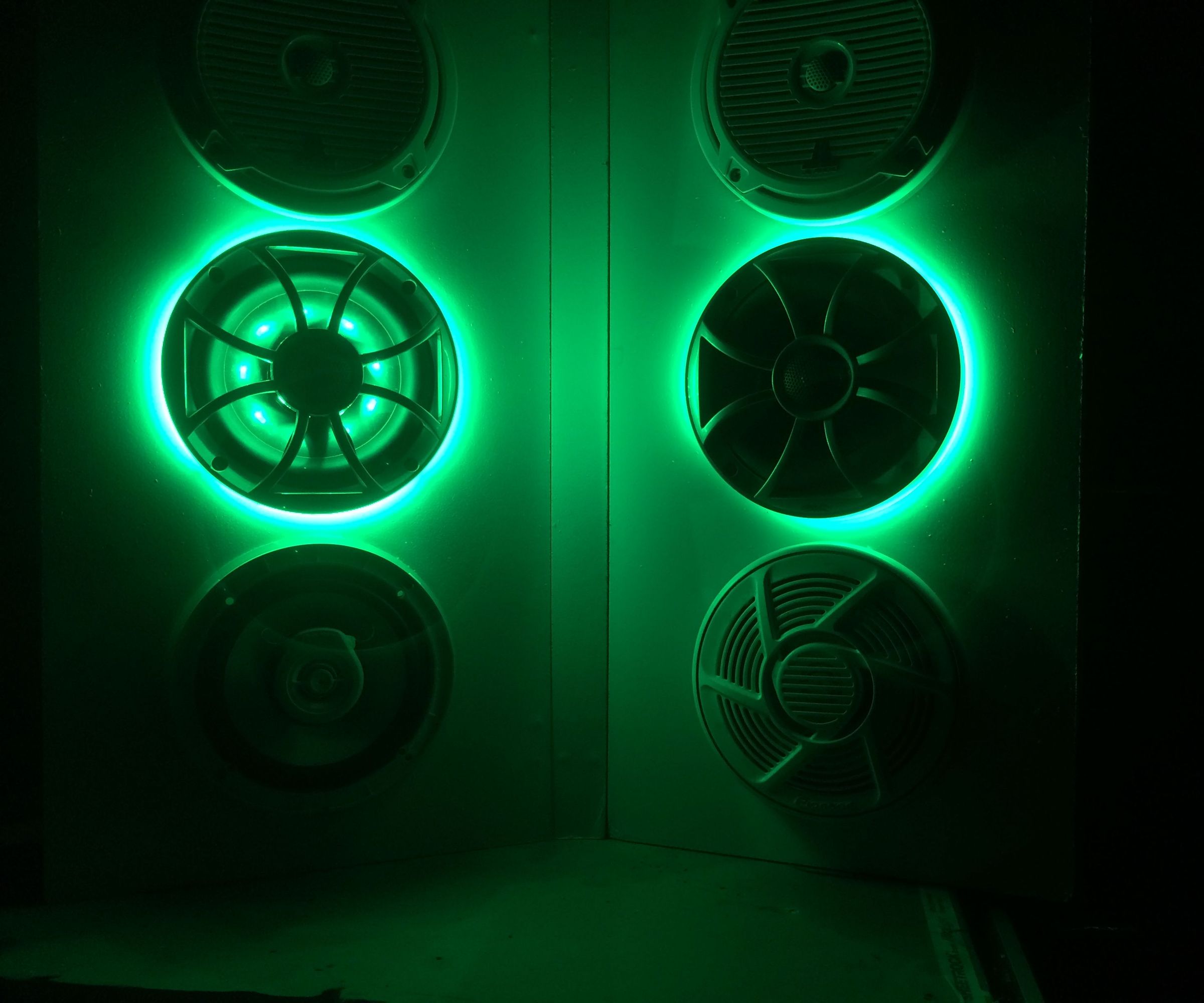

Introduction: Color Change Halo Install 3" Pod
Please let us begin by thanking you for taking the time to view this instructable. We have created this to give you (the customer) the confidence and know how to make your vehicle a one of a kind light show.
