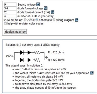

For this, you need a couple pieces of info about your setup:
1) The voltage of the battery (In this case, 9v)
2) The forward voltage drop across the LEDs you chose
3) The current you want to run the LEDs at
4) The number of LEDs you want to use.
Once you have this info, head over to your favorite LED resistor calculator and plug your numbers in. That link will also draw you a schematic, in case you need help in that department also. In my case, the forward voltage on my LEDs is 3.4v, and the current they require is 20ma. Filling in the info in the calculator, it suggested 120 ohm resistors. I had 100 ohm resistors already, so I just used those.
