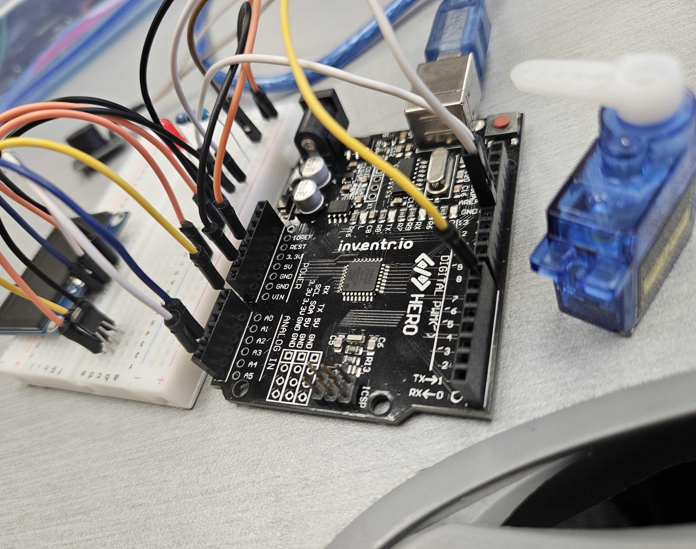

This Arduino project uses a Light Dependent Resistor (LDR) to measure light levels. When the light level drops below a set number (700 for this project), an RGB LED begins flashing through a sequence of colors. This project is a good way to learn how to code and LDR, calling on functions, and coding LEDs. Skills like these will be especially important to have if you are thinking of a career in computer science or coding.
  1. 1 x Arduino Uno R3 - runs the code for this project.
  2. 1 x RGB LED - flashes the colors that are set in the code.
  3. 1 x LDR (Light Dependent Resistor) - detects the light level, determining if the LED will be on or off.
  4. 1 x Bread Board
  5. 9 x Jumper Wires - Go for Male to Male wires
  6. Resistors:
  7. 3 x 220Ω resistors - for each of the RGB LED pins.
  8. 1 x 10kΩ resistor - for the LDR.
  9. 1 x Paper Cube Cut Out (Optional)
Step 1: Connect the Arduino to the Breadboard
5V → Bread Board positive strip (+)
GND → Bread Board negative strip (-)
Step 2: Connect the LDR
Terminal 2→ 5V
Terminal 1 → A0 and one end of the 10kΩ resistor
Other end of the resistor → GND
Step 3: Connect the RGB LED
The order of pins will be one of three ways:
  1. RCBG
  2. RCGB
  3. BRCG
The Cathode pin will always be the longest pin on an RGB LED.
  1. Red Pin (R) → 220Ω Resistor → Digital Pin 11
  2. Cathode Pin (C) → GND
  3. Blue Pin (B) → 220Ω Resistor → Digital Pin 10
  4. Green Pin (G) → 220Ω Resistor → Digital Pin 9
