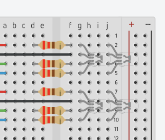

Step 2: Wire RGB LEDs in Pairs
Group the LEDs into 2 pairs (1 & 2, 3 & 4).
Connect all Red pins in a pair together → resistor → PWM pin.
Repeat for Green and Blue.
Connect all cathodes to GND.
