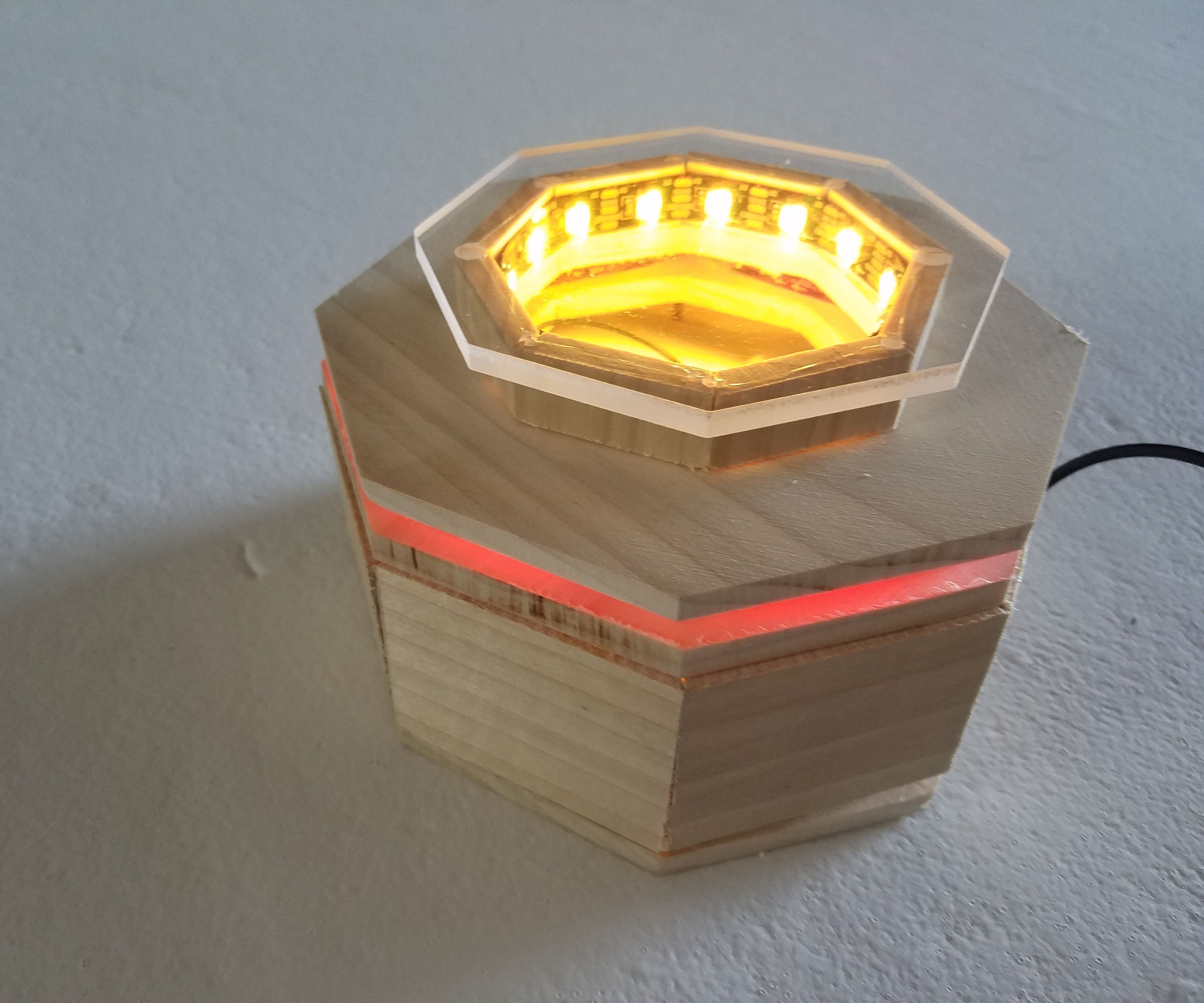

This is a clock that gives the time by color. Right now it only gives it to you by the hour. The goal was to make a simplistic enough clock with out the need of digits. I do plan on enhancing and expanding the clocks functionality but for the time being this is what it perfoms. I apologize ahead of time as there will be a lack of pictures since half of them were lost.

Step 1: Wiring
Connecting the rtc to the arduino is as follows.
RTC
GND - GND
VCC - 5v
SDA - A4
SCL - A5
For the Neopixel you will connect.
DataInput - 470ohm resistor - pin 6
GND - 1000uf capcitor Negative - GND
PWR - 1000uf capcitor Negative - 5v
Important to note that the neopixel shares the 5v pin with the rtc. The neopixel also requires its own ground pin and is not recommended to be shared. From what I found when done the leds do not glow as brightly. Another note is to use the pwr and gnd holes that are next to each other on the neopixel ring.
Step 2: The Code
The code currently just sets the color. In the setup it is important that the strip setup is placed before the rtc setup or else the sketch will not properly work. I am not well versed in coding so I am sure there are much more efficient ways to implement this but it works for what it does. There is a blank fade function there but it currently does nothing so it can be ignored.
Step 3: Building Enclosure
For the actual casing of the clock I had used a CNC machine to but this out. Holes are made on the top piece the neopixel sits on for to route the wires. Glass frosting was used on the acrylic to diffuse the light (multiple coats recommended). One coat of dark mahogany stain was applied to the wood to achieve the color you can apply multiple coats to achieve a darker color. A sketch up file is included for the model of the clock. (Note the components are taped down so as to be accesed at a later date.
