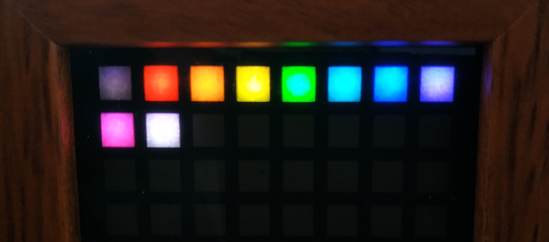

2. List of 20 Simple, Distinct Colors by Sasha Trubetskoy
It's an interesting list, easy to understand, I chose in the interactive graphics: Color order: Convenient and Color code: HEX (to see the colors hex values) then I chose different percentages at Accessibility some usable color lists was generated, the list of the most distinct colors I have tested (with Accessibility 95%) are the ones below
"#111111","#e6194B","#f58231","#ffe119","#3cb44b", "#42d4f4","#4363d8","#911eb4","#f032e6","#919191"
and you can see on the display the result:
Much better...
