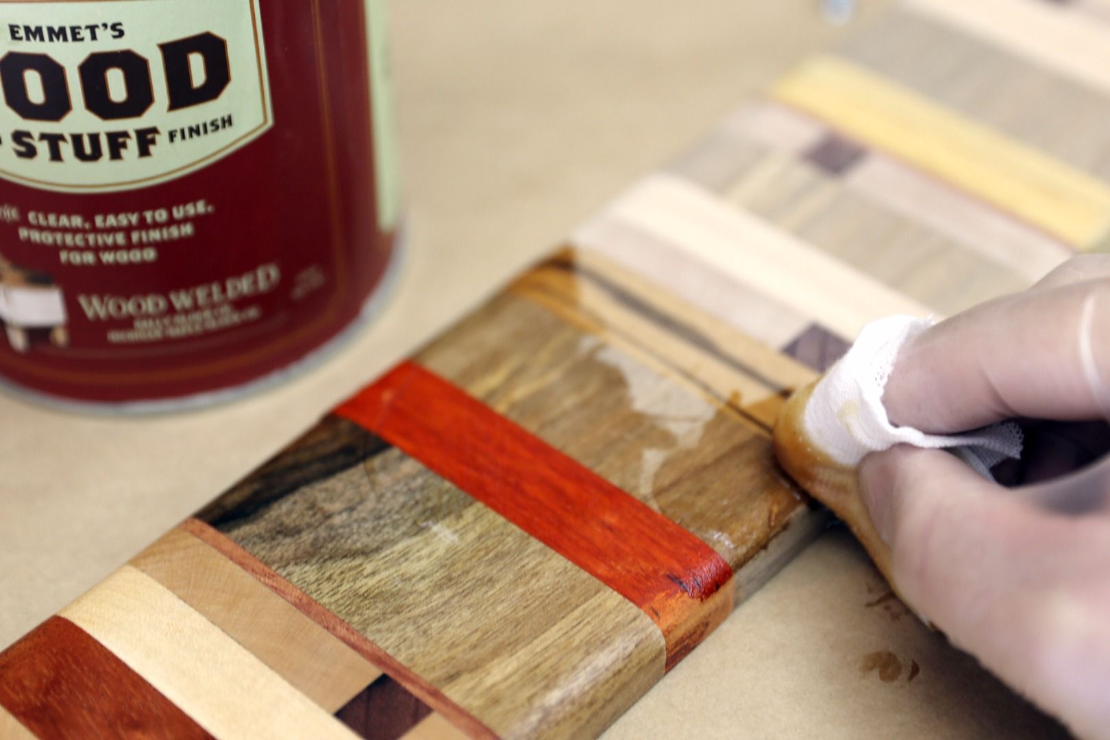

Stains:
Wood stain is a colorant mixed suspended in a solvent - since stains are solvent-based they cure. The colorant can be a dye or pigment.
Pigments and dyes are largely used as colorants. The difference between the two is in the size of the particles. Dyes are microscopic crystals that dissolve in the vehicle and pigments are suspended in the vehicle and are much larger. Dyes will color very fine grained wood, like cherry or maple, which pigments will not. Those fine-grained woods have pores too small for pigments to attach themselves to. Pigments contain a binder to help attach themselves to the wood.
The type of stain will either accentuate or obscure the wood grain. Most commercial stains contain both dye and pigment and the degree to which they stain the appropriate wood is mostly dependent on the length of time they are left on the wood. Pigments, regardless of the suspension agent, will not give much color to very dense woods but will deeply color woods with large pores (e.g. pine). Dyes are translucent and pigments are opaque.

You may have found a color of stain or oil you like in the store but it can look very different depending on what wood it's applied to, sometimes there's a sample stick in the stain aisle to help you out and give you an idea.
Once you have a collection of colors in your own shop you can start your own stain stick (as seen above). Remember to number your samples to correspond with each can. Remember that stains will look different on different types of wood.
When you have a color you like, before you commit to covering your work test your finish on a hidden area of your work, like the back, underside, or inside. These "hidden" areas won't be seen by anyone and will give you an idea of the look of the stain. Allow the stain to dry before making the call, also try applying a second coat in the hidden area.
If there's no hidden area to your work you just need a scrap of the same type of wood (ideally a cut-off from the same section).
