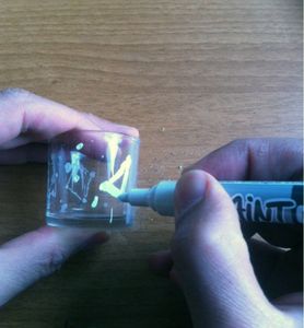

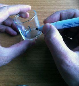

Step 2: Draw Your Subject.
Use the whiteboard marker to draw whatever you like. Since you can delete and repeat, this is a nice way to play with a subject without having to committ it permanently to the chosen object. Your fingers will easily wipe off the marker, so be careful while you manipulate it, or just work on a small area at a time.
My topic of choice is Constellations, so I drew the same one that can be found on Constellation Dice, minus the glow in the dark effect :)

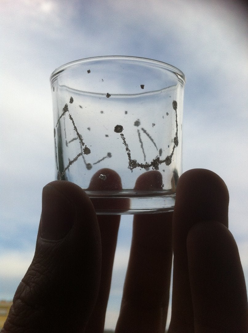

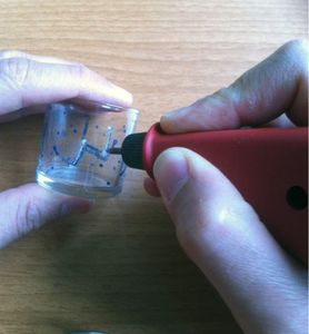

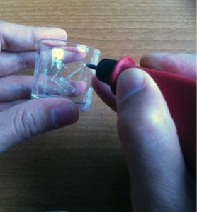

Step 3: Etch a Sketch
Start etching lightly with the electric engraver, first defining the shape, then going deeper.
I suggest to draw "in the air" in front of the marks before touching the surface, to train your muscles and deliver the master touch that doesn't need a correction.

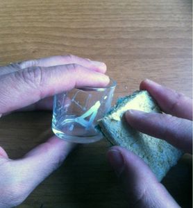

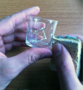

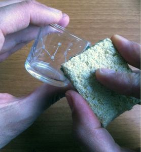

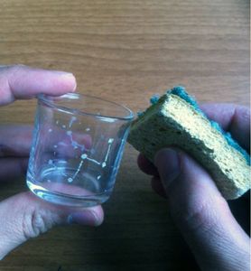

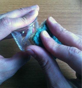

Step 4: Clean It Up
Wipe of the glass dust by using the sponge.
This way you will also remove any remaining sign of the marker.

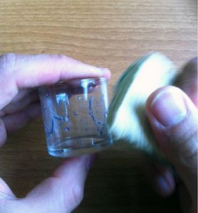

Step 5: Once More...
Repeat the previous steps until you have completely finished etching the drawing you have only sketched with the whiteboard marker.

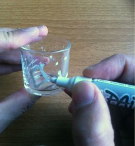

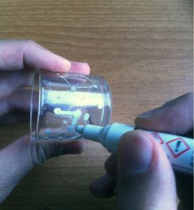

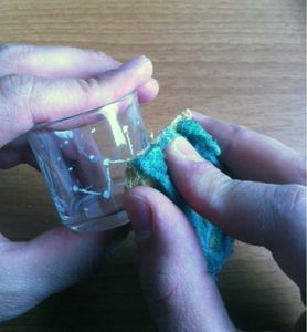

Step 6: Fill in the Gaps
Use the enamel marker to fill the etchings. No need to be precise, just cover all the area you have just engraved. I have used white as a color so it will not be very apparent, but bright colors work as well and will not be easily removed by manipulating the glass afterwards, since the paint will be under the surface level.
Remove all the extra paint while it's fresh. Quick!

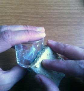

Step 7: Wax On, Wax Off.
I know you have enjoyed it, so do it once more.
Step 8: And Again.
Yes, you have guessed the right way to do it. Same as before.
Step 9: There You Go!
Your glass is now properly etched, in color!
