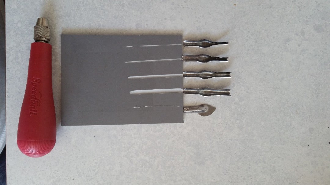

  • Speedball produces a nice linoleum cutter kit that includes a handle and several interchangeable blades. The blades vary in size and produce different types of cuts, from fine, delicate cuts ideal for detail, to broader, shovel-like ones better suited to carving out larger areas of material.

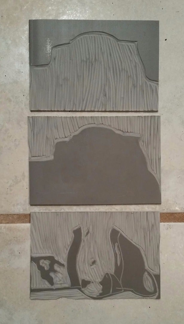

  • To use the multi-block printing method, you're going to carve a separate block for EACH color you want to use. The example we're looking at here requires three linoleum blocks: one for the blue sky, one for the tan church, and one for the brown shadows. If you're new to multi-block printing, try not to use too many colors at first.
  • Once you have broken down your design into the colors you want to use, transfer the outline for each color onto a block. If you don't want to eyeball your work, insert a sheet of transfer paper between the linoleum block and design, then trace over the design with a pen or pencil. This will transfer an exact replica of your initial design onto the linoleum. Repeat this step for each color. See the photograph above to see the different color blocks used for this particular print.

  • Using your linoleum cutter, carve out the negative spaces on each block. For each block, you're only going to carve away the areas that you don't want to have printed a certain color. To take our three-color example, for the blue sky block, we're only carving out the sections that we don't want to appear blue. For the tan block, we're only carving out the areas that we don't want to appear tan, and for the brown block, we're only carving away the areas that we don't want to appear brown. See the photograph of the three blocks as examples.

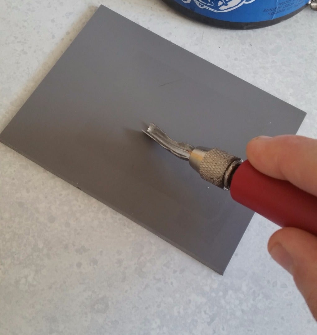

  • When carving, apply mild to moderate pressure to move the blade forward and through the linoleum. Be sure to carve away from your body at all times. Linoleum blades are very sharp, and you don't want to accidentally cut yourself.
  • When carving out large areas, try overlapping your cuts to ensure that you've carved out the area thoroughly.

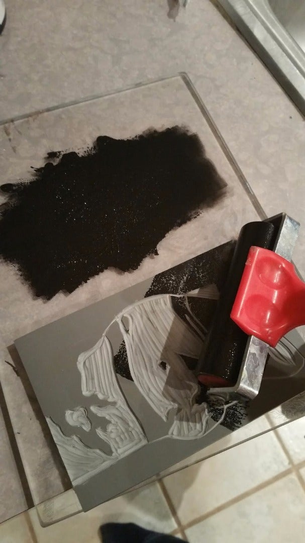

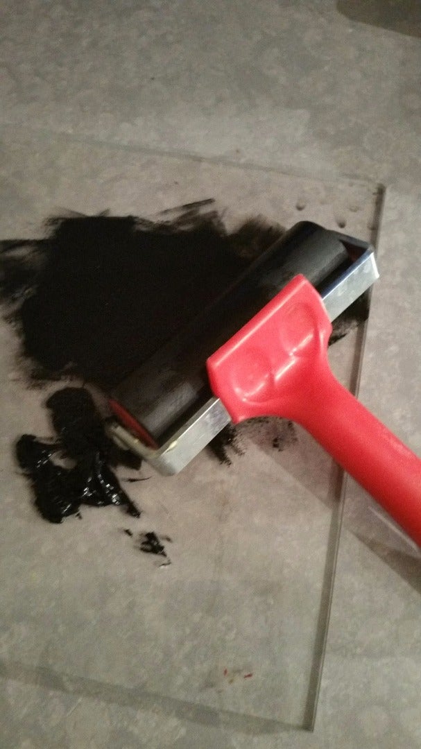

  • Take your brayer and roll it over the ink. Push the ink in different directions until you've flatted it into a thin, leathery surface, and have covered the roller in an even layer of ink.
  • Take your coated brayer and roll it over the block until you've covered the entire surface in ink. Reload the brayer with ink as needed.
  • For multi-color blocks, I recommend mixing and printing your colors one at a time. Water-based inks dry quickly, so it's easier to keep track of one block instead of several at once. If necessary, spritz your printing ink with water if it starts to dry out.

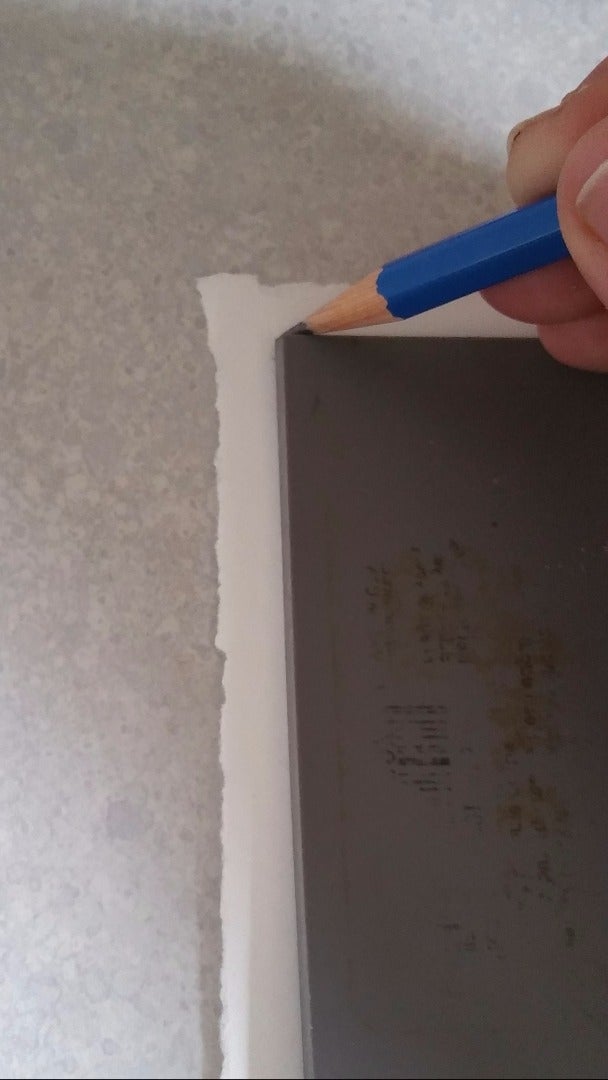

  • Since you'll be printing multiple blocks on the same sheet of paper, you'll want to make sure that each block is placed in the exact same area on your paper, otherwise the print will look messy. This alignment is called registration. To help ensure registration, take a pencil and draw around one of the corners of the first printing block. When you print subsequent blocks, you can line them up with the corner you traced to make sure they all are printed in the same place. As you print your blocks, the outline of the block shape will also leave an impression on the paper, which can help you guide your blocks into the same spot.
