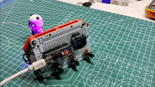

Step 5: PCB Breadboard Edition
After checking the breadboard version, we recreate the whole board on a PCB breadboard. The PCB breadboard is a small project I made that is a double-sided board consisting of holes for adding components, as we add components to a breadboard to make a permanent circuit.
We use header pins and add wires on the back side with a soldering iron to make a proper circuit board that connects all the components to the Arduino board in the same pin alignment as the previous breadboard version.
The code will remain the same for this, as we are just changing the breadboard and keeping everything the same.
Step 6: 3D Printed Holder
For connecting the matrix with the baseboard, I modeled a simple circuit holder that holds one PCB on the bottom side and another one on the top side by using four mounting screws.
As for 3D printer settings, PLA was used with a 0.4 mm nozzle.
Layer height was set at 0.2 mm, and infill was at the usual 10%.
Step 7: Final Assembly
  • We first solder VCC, GND, and Din Pin of Matrix with 5V, GND, and D9 of Arduino Nano.
  • After this, we add the 3D Printed circuit holder for mounting both PCBs together by using four M2 screws.
  • Assembly is completed.
Step 8: Complete Board
Here's the result of this build: a working RGB light source that is completely DIY and made by using stuff that I had, so no additional parts were purchased, and the cost of this project is super low compared with the actual RGB lightbox.
As for the final version, I used 64 LEDs to increase the glow and save a bit of power, as this matrix has 128 LEDs, which we can also utilize if the code is altered a bit.
