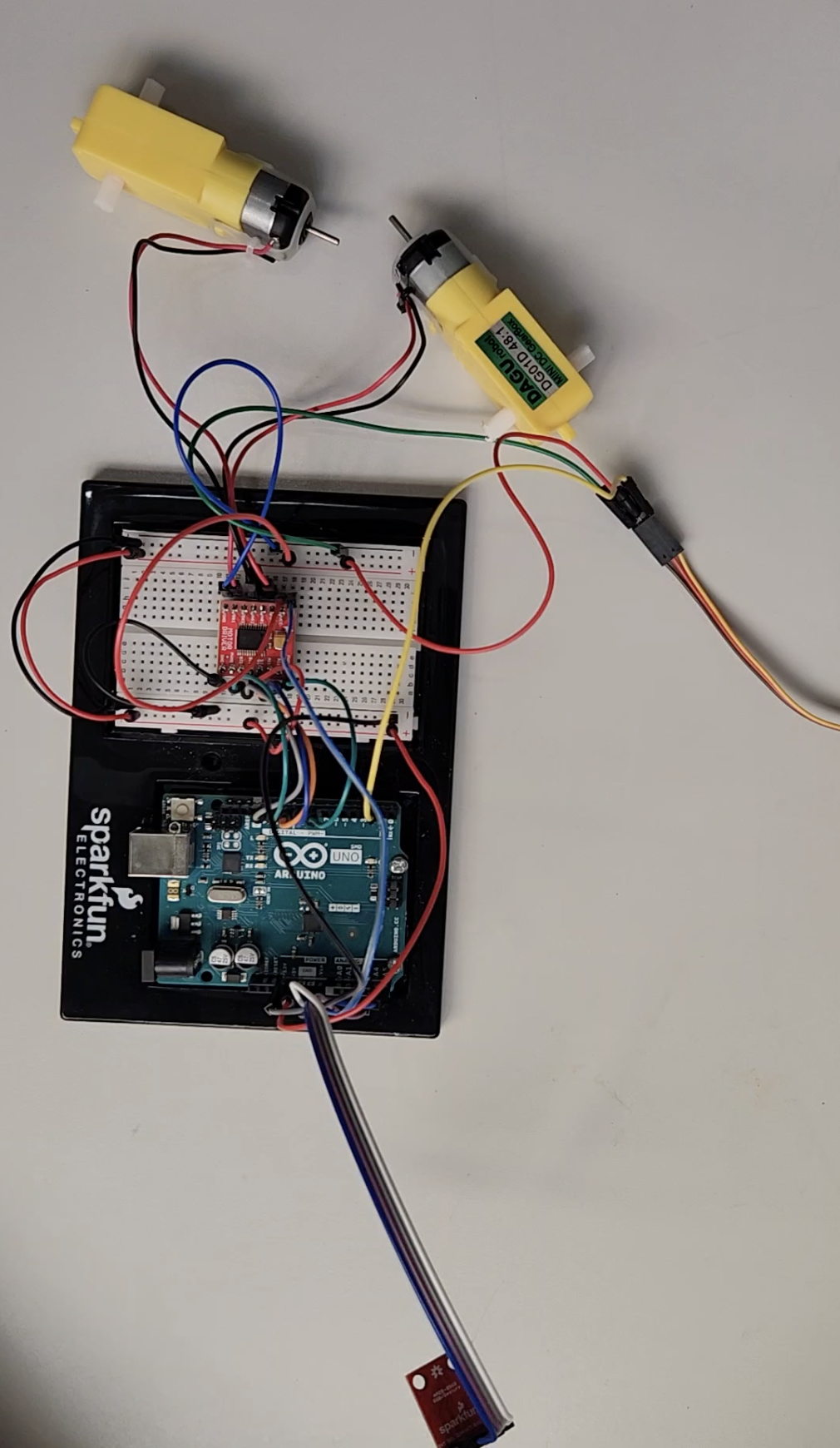

Step 2: Wiring
Tools needed
  1. Breadboard
  2. Arduino Uno
  3. Motor Driver
  4. 4 wires
First, we need to form a connection from the breadboard to the Arduino Uno
  1. Positive supplies power, connect to 5v
  2. Negative connects to ground (GND)
  3. Then connect the positive on one side of the breadboard to the other side
  4. Do the same with the negative
  5. Add the motor driver to the Breadboard as shown
  6. Connect PWMA to 11 on the Arduino Uno using a wire
  7. Connect AIN2 to 12 on the Arduino Uno
  8. Connect AIN1 to 13 on the Arduino Uno
  9. Connect BIN1 to 10 on the Arduino Uno
  10. Connect BIN2 to 9 on the Arduino Uno
  11. Connect PWMB to 10 on the Arduino Uno
  12. Using a red wire connect STBY to positive on the breadboard
  13. Using a black wire GND to negative on the breadboard
  14. Connect VM to VIN on the Arduino Uno
  15. Connect VCC to positive on the breadboard
  16. And finally connect both of the GND on the top of the motor driver to negative on the breadboard
  17. Connect the red wire of the first Hobby Gearmotor to A01 on the motor driver
  18. Connect the black wire of the first Hobby Gearmotor to A02 on the motor driver
  19. Connect the red wire of the second Hobby Gearmotor to B01 on the motor driver
  20. Connect the red wire of the second Hobby Gearmotor to B02 on the motor driver
Servo Motor
  1. Connect the left pin (Ground) on the Servo Motor to negative on the Breadboard using a black wire
  2. Connect the middle pin (Power) on the Servo Motor to positive on the Breadboard using a red wire
  3. Connect the right pin (Signal) on the Servo Motor to A0 on the Arduino Uno using a colored wire
Color Sensor
  1. The color sensor has 6 pins but for this project we are only using the inner 4
  2. First connect the GND pin to GND on the Arduino Uno
  3. Then connect the VCC pin to 3.3V on the Arduino Uno
  4. Next connect the SDA pin to A4 on the Arduino Uno
  5. Finally connect the SCL pin to A5 on the Arduino Uno
