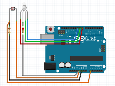

Connect the sensor to the Arduino as shown in picture 1: the red wire to pin 8, the green one to pin 9, the blue one on pin 10, the LED anode and the right photoresistor's pin to 5V, the left photoresistor's pin (the orange one) to A0 and the other right pin (the one connected to the 10KΩ resistor) to ground.

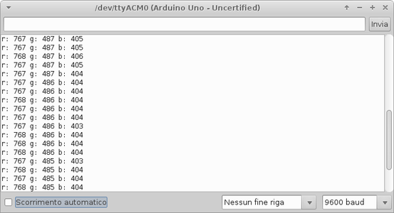

Upload the calibrateColors.ino sketch into the board. Pick an opaque white object and put the sensor on it. While keeping the sensor in place open the serial monitor in the Arduino IDE: you should see something like the picture 2. Write down these values. Now place the sensor on a opaque black thing and write down these new values. Close the serial monitor.

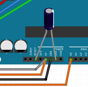

Now, pick the 10μF capacitor and put its negative pin to ground and the other
pin into the reset pin as shown in picture 1. This capacitor is used to disable the auto-reset that occurs when a serial communication is established between the Arduino and a computer. Remember to pull this out when you want to upload new code into the board.
