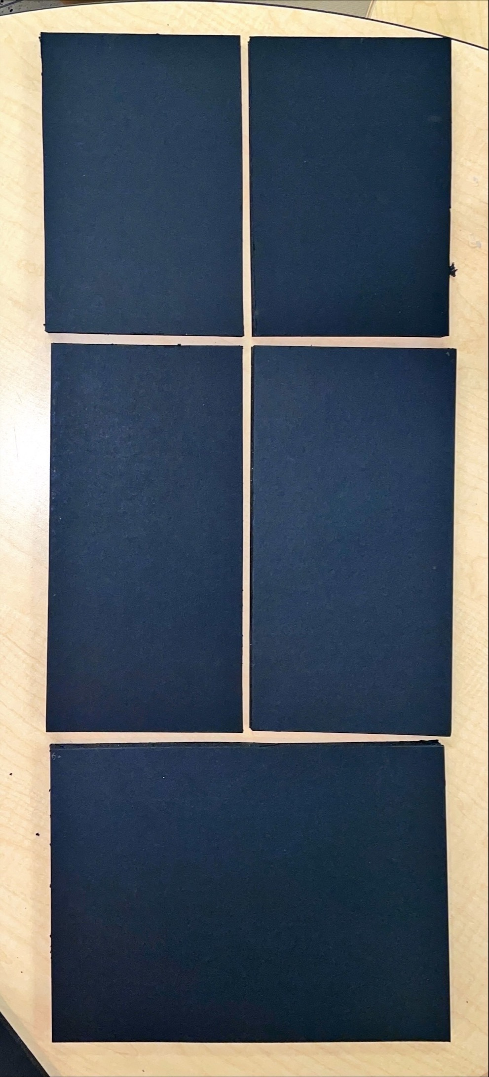

Step 1: Trace the Parts of the Stage Onto the Foam Board
The first step will be to trace the parts you'll be cutting out of the foam board that will be used to build the stage (as shown above). You'll need to cut the following pannels:
- 1 back panel (dimensions are 9in x 12in). Label this panel with a B
- 2 side panels (dimensions are 9in x 5.5in). Label these panels each with an S
- a top and bottom panel (both of which have dimensions of 12in x 6in). Label one of these panels with a T and the other as B
Tip for tracing: Make that while tracing the initial panels, leave enough room to be able to cut a front panel in future steps (this is partially where the LEDs will be mounted and has dimensions of 12 in x 2.5 in). It may be easier to get square corners by using the corner of a book.
Step 2: Cut the Traced Panels
Using an X-Acto knife, cut the drawn panels drawn on the foam board in step 1. To yield a clean, straight cut, it is recommended that a metal ruler is used as a straight edge. Place cardboard, plywood, or another thick material below the section you are cutting to avoid marking up your work area with cuts. It may take more than one pass along a cut to cut all the way through the material.
