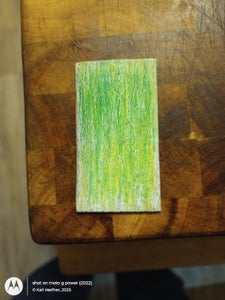

Step 11: Updates
This first picture is just of a color test I did using yellow and three shades of green. I did not seal the piece, as it was intended just to play with pencils.
