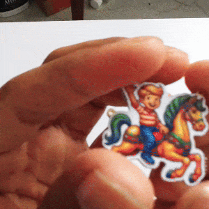

Once the shapes were ready, I exported the DXFs from Onshape and imported them into Inkscape to create the graphics. For the boy and girl figures, I also exported and imported the DXFs back into Onshape to create the templates.
Finally, I imported all the graphics back into Onshape to check how the carousel would look visually before moving to fabrication.
Disclosure: kids and flowers were first ai generated, then edited in inkscape.

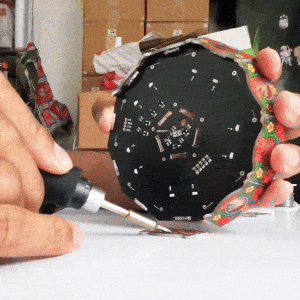

Step 3: Assemble and Solder
Needless to say, this is the most satisfying step. The feeling of everything fit together never gets old.
First, de-panelize the boards from the panels. Be careful if you're doing this with bare hands, it left a few scratches in my fingers.
Then its just soldering work. Arrange the PCBs and solder it as per the 3D model. While soldering the LEDs, make sure to check correct polarity.
